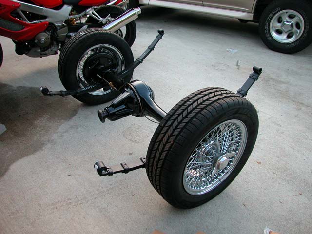

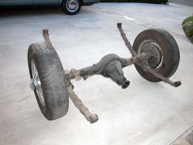

That's exactly what I did, only without the strap mount replacement. A quick brake pipe replacement turned into a complete rear end restoration.
Before and after...

That axle was spray painted and the springs were replaced. I did POR15 the axle from, another car. Had I known about POR15 was back when I did the first one , I would have used it.
