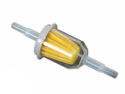

I prefer to have the paper element filter after the pump, so the sediment bowl & screen can still catch most of the gunk. So I trimmed back the hard line a bit, and reshaped it so I could mount an in-line filter between the hard line and front carb. It's a bit hard to find 1/4" filters at FLAPS, so I picked up a box of them on eBay.

One other point, last time I went through this with a buddy's TR6, he found what seemed to be a nice little reusable screen filter at FLAPS. It looked great with a clear center section (making the screen visible) and chromed ends, but it turned out that the ends were chromed plastic rather than steel and it broke after just a few months of service.
This is probably not the same filter, but it looked very much like this:
So my suggestion, if you buy that style of filter, then make sure the ends are steel, not plastic. Personally, I prefer the one piece paper element filters, but I suppose they do contribute some small amount to landfills every year.
dklawson
On my Mini I have the filter Randall shows above located between the tank and fuel pump. It is a fairly coarse filter and catches the larger sediment. The elements are replaceable and I keep spares (along with the end cap o-rings) in the car in case something happens on the road. I also have a cheap, translucent paper element filter right before the carbs. The disposable filter is the type that used to be very common on air cooled VWs. Together both filters do a good job of keeping debris out of the fuel pump and carbs. I also have the VW filter right before the carbs on the GT6 and the Spitfire.
