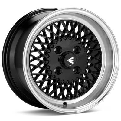

I was thinking of something like the Enkei Classic 92 in black would look good on a silver car. It is available in a 15x7, +38mm offset. So if I could get some 19mm adapters like yours, that would make the effective offset +19mm, or 6mm less than stock. That is about a quarter inch, which might be OK?
The only problem is I haven't found a picture of what I'm sure is that wheel. I don't think it would have as much rim as this one in the picture. Though 38mm is about 1.5 inches, so that would put the back of the center 2 inches from the outside edge of the rim. If the center mesh is 0.5 inches thick, that would leave about 1.5 inches of outside rim. I just would like to be able to confirm that!

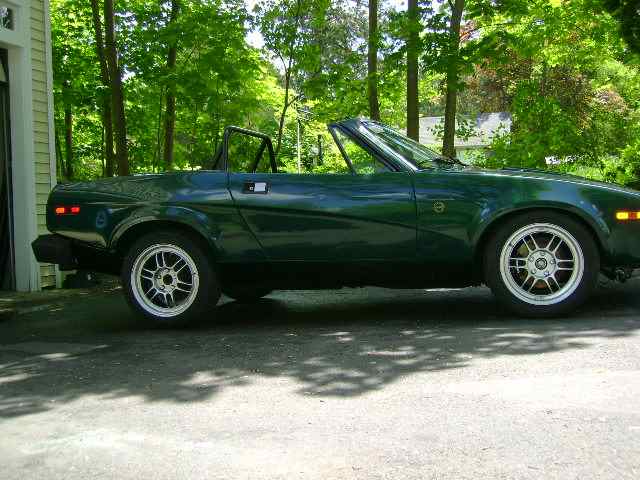

tr8todd
Doubtful. Most wheels will have a center hub that is at least 1" thick. If you see a set of wheels for sale in the same size but with different offsets, one size will have even more material on the center in order to achieve the desired offset. For instance. Take the Enkei RPF1 in 15X7. They come in a 35 and a 42mm offsets. The listed weight is 9.9 pounds, but only for the 35mm offset. They don't list the 42mm weight so prominently in the advertising as it has extra thickness on the center section which raises the weight slightly. The Enkeis, along with the panasports seem to be the prevelent wheels at SCCA events. The Enkeis because of the weight to cost ratio and the panasports because of the strength and available offsets and sizes. Here is a picture of the Enkeis on a TR8 with a changed bolt pattern.

Hi Todd,
I was thinking more of how thick the center would be out at the rim.
The Classic92 comes in two sizes, 15x7, +38mm offset and 15x8, +25mm offset. I'm pretty sure that the picture is of the 15x8, and it is the only picture I've been able to find so far.
