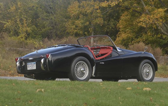

I put on 185/70-15's (Vredestien Sprint Classics) on my TR3. The diameter of 185/70-15s is almost exactly the same as 165/80-15s. They fill the wheel wells nicely and I feel they look right for the car.
