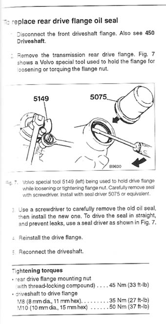

According to the shop manual, it can be done without removing the transmission. Below is the entire, super-complicated procedure.

Not difficult at all. No special tool needed either. Impact wrench took it right off while holding the flange. Somebody had been in there before and used the wrong bolts on the old case where the transmission mount attached, the bolts were too long and didn't seat properly. They wiggled around and ended up breaking the case which was why it was leaking. Took care of that on the re-installation. Its all good now.
