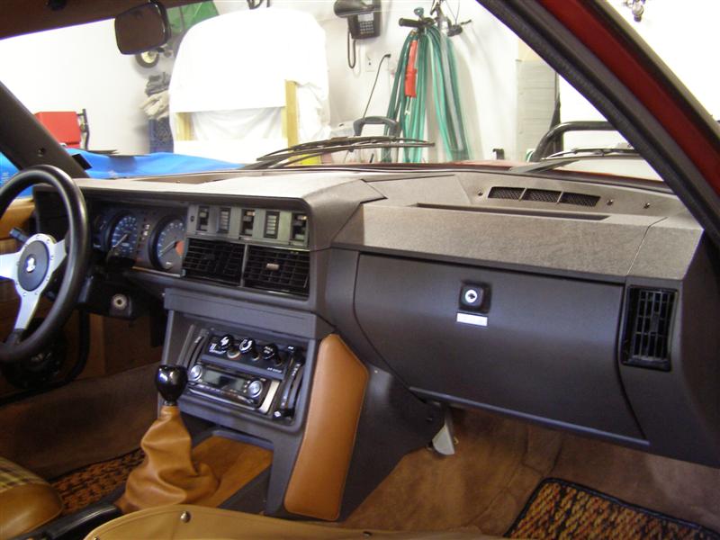

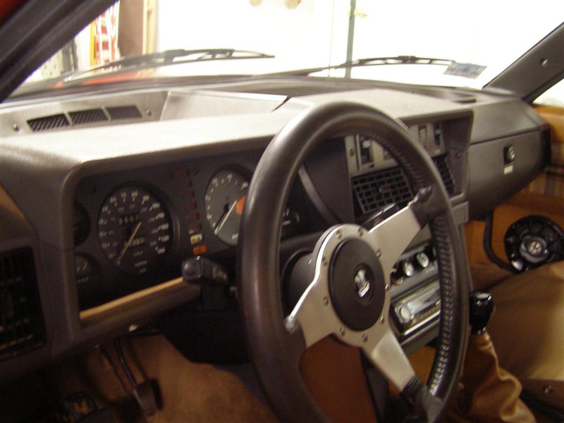

I just tried and had some reasonable success on the TR8 dash with Armor All Tire Foam. I applied it heavy three times and used an old wash cloth to rub it in really well, keeping it wet and never really allowing it to dry. Now I'm letting it sit overnight to see how it looks after a few hours and I'll let you guys knoe who it worked.
That was the instructions from the guy who used it on his black plastic dash and his looks really good today. Apparently, this helps rejuvenate the dried/sun bleached out plastic, just like it does for the tires.
We shall see.......

Doc, you are right it is sun, but this rejuvenated the dash nicely, so I'm happy for now.

I meant to convey that sunlight will help the foam soak into the parent material better/more quickly. It looks really nice, BTW!
:thumbsup:
OH!!!! The second application will take place in the sun this weekend, if that's the case. And thank you. It was nice when I got it from Mickey, just a little light on the flats on top.
