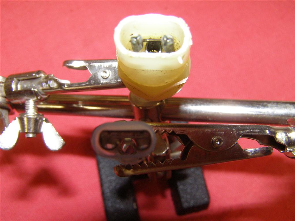

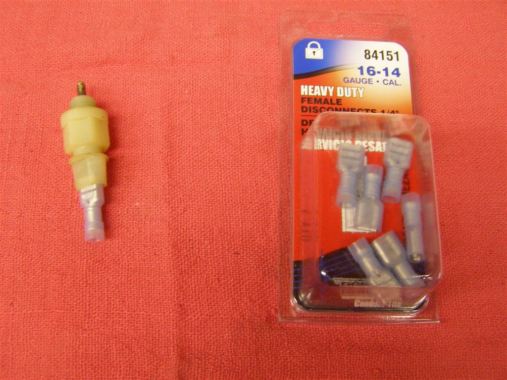

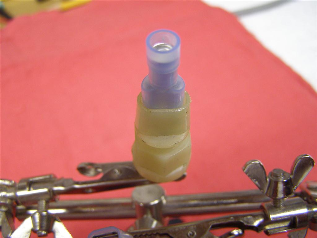

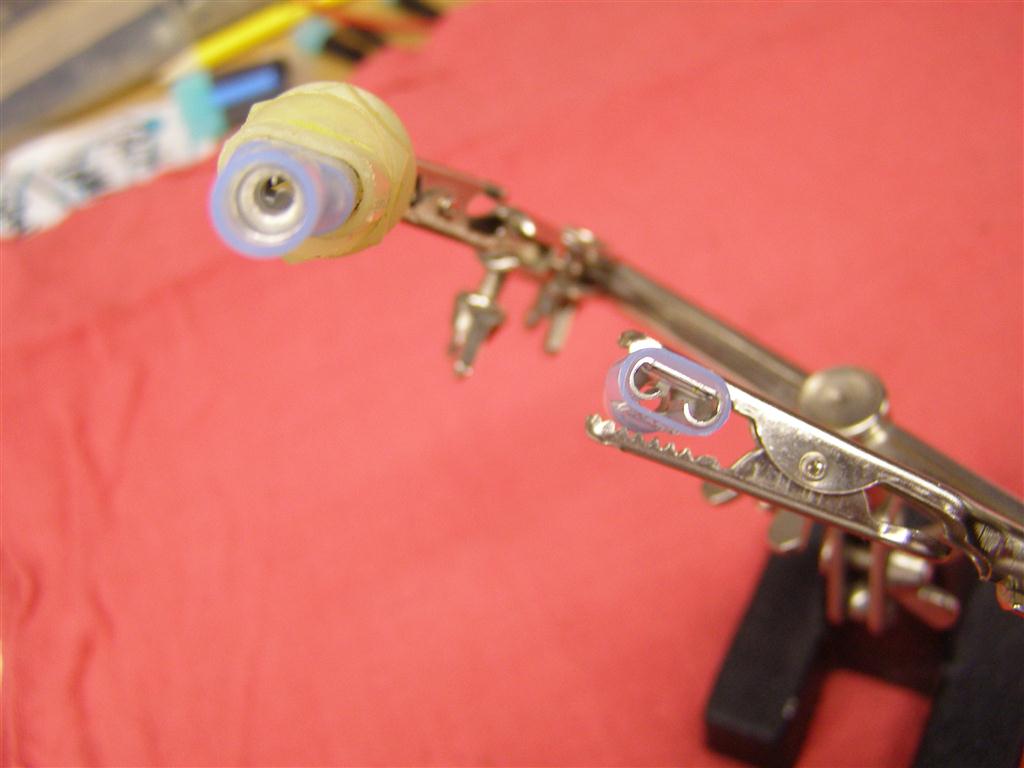

Take a look at this for your PDWA connector. It's better than the factory setup.

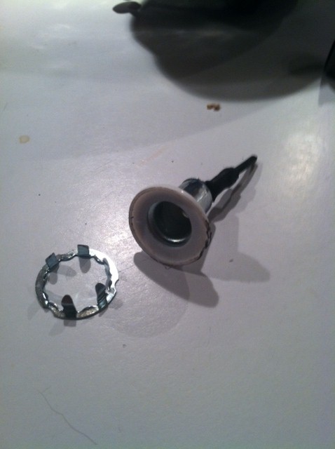

no all the new ones including from British Wiring are plastic bases with the metal spring clip that goes into the gauge. when you try to pull the base out to replace the bulb the metal spring clip separates from the plastic base and stays in the gauge, so the only solution is to replace them with old metal ones, at this point I dont mind splicing them in since I will still have the correct color wires., Maybe I will take a photo of the plastic ones and post, but having said that, the plastic is all thats available now. so if you plan on replacing your harness I suggest you keep your old bulb sockets and replace them on the new harness before you install it in your car. Unfortunately my old harness was so mangled that I didnt have but 3 original bulb holders the rest were missing, thats why I am searching for help getting old ones. It is possible to put the old one in place with out splicing, its tedious but can be done, you just have to do some operating with tweesers and soldering and get that center contact out and solder the new wire on and pull it back into the housing. the outer wire is just soldered on the outside thats the easy one

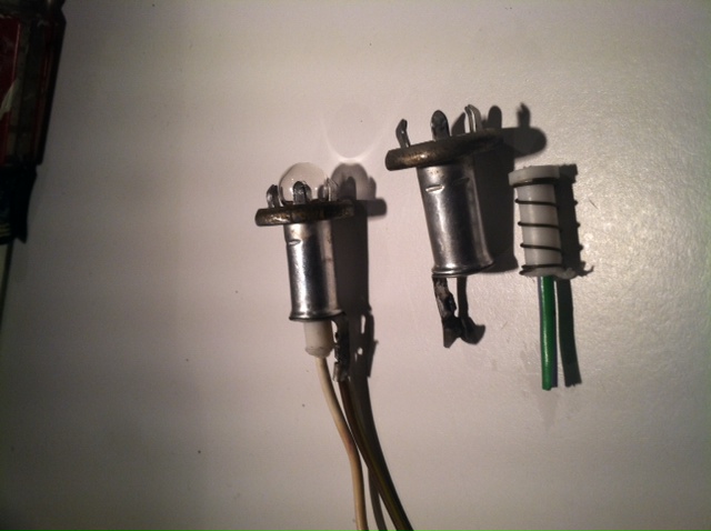

ok here are the new plastic bulb holders, that metal clip that holds the socket in the gauge is suppose to be in the plastic ring.

Thanks for the pic. ow I know what they've done.
Any chance there isn't another style of bulb holding that will fit those holes?
hondo402000
hondo402000
as far as I know and have been told, thats the only type supplied, and even the manufacturer is not happy but its all they can get. So unless you save your old ones and splice then in place or get some really good plastic/metal glue and glue them in, once you pull them out to replace the bulbs the metal clip part separates from the holder and it stays in the gauge or in my case the plastic parted ways with the metal clip from just driving.

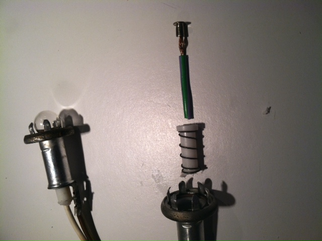

here is the first repaired bulb holder, the Ign lamp, BY wire on the outside soldered to the holder and White on the inside you can see the old style holder below and you can get the center out if you are careful. but I will still have to use a butt connector on the white wire and heat shrink tubing but all wires will be correct color coded,
it is possible to pull the center contact out of the plastic housing, but the center contact is crimped so there is no way to pull it out and re crimp so you would still end up doing a butt joint somewhere in the harness

hondo402000
hondo402000
here is a photo of the center contact out of the plastic holder and it shows the spring that puts tension on the bulb
