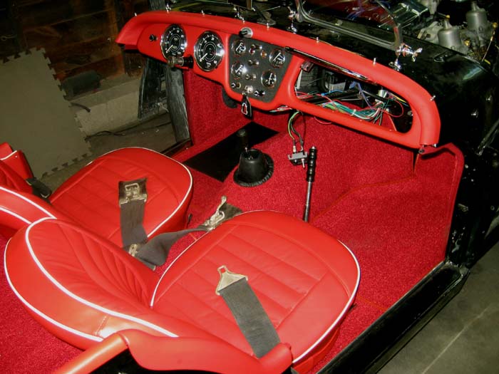

I bought a complete interior from TRF, as I was getting it all in leather (including dash, cappings and door panels) and and figured that if I got it all at once, the match on the leather would be good, which is was. I also got the horse hair and padding kits. The process was pretty easy and straightforward, the hardest part was repairing the steel seat bottoms and replacing the wooden tack strips. My seat springs were in very good shape. I used staples instead of tacks.
Redoing the seats yourself is very doable.

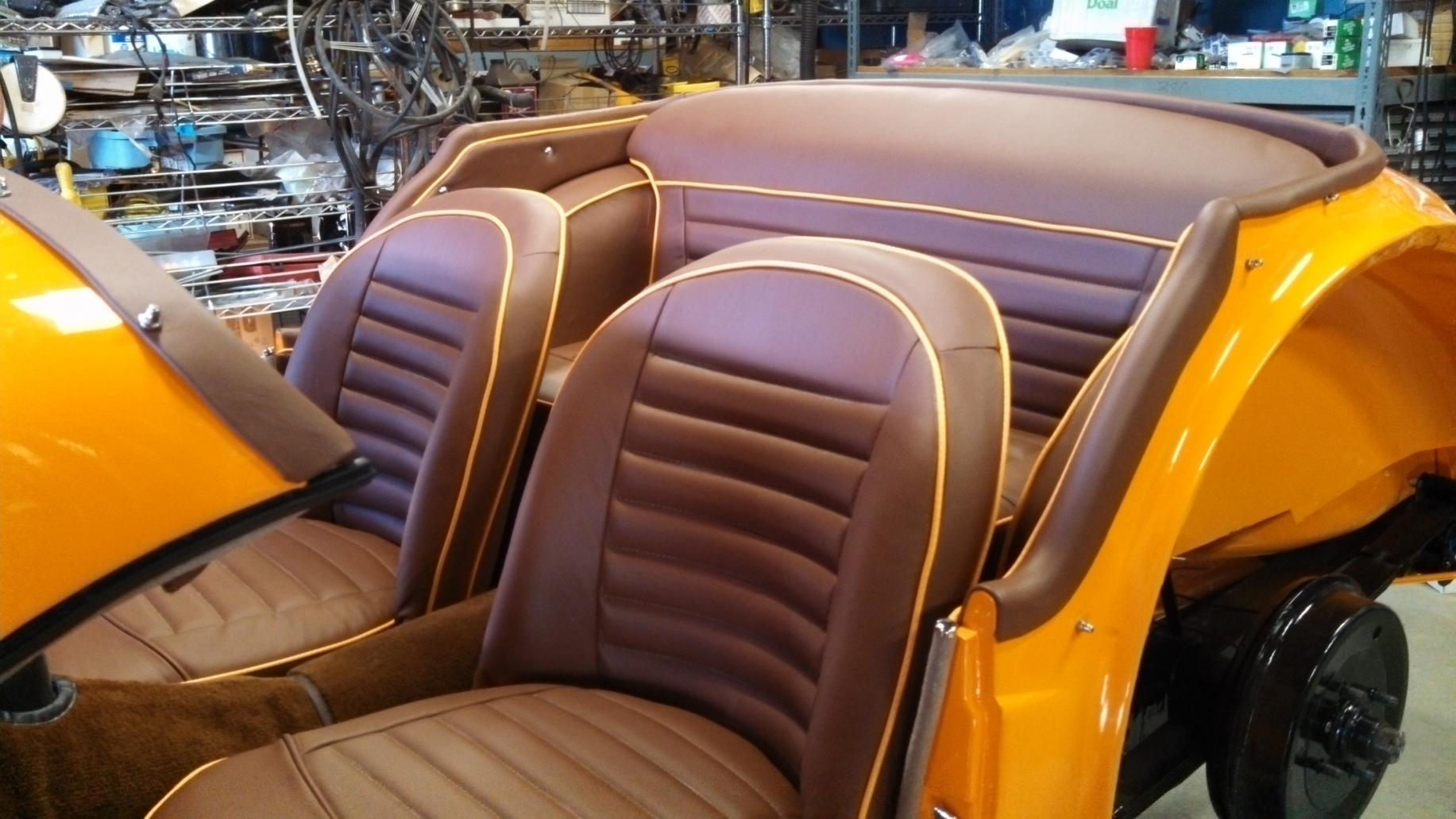

too tall makes seats also, but as long as your frames are not really rotted, you can repair them. The advantage of too tall is that he will make any color you want. See my picture . I have bought from MOSS, others and too tall and I think his rate up with the rest. interior 1.jpg

That looks fantastic, is that the bright red they were selling at one time? I don't even see TR3 interiors on their web site anymore?
Thanks, I got that leather from TRF maybe eight years ago. It's generally pretty bright, but if you get it in an overcast day, the color seems to calm down.

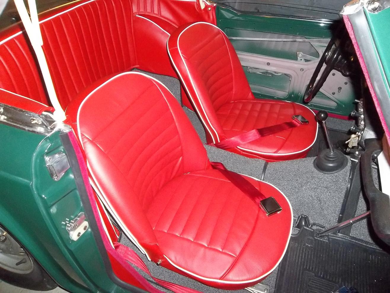

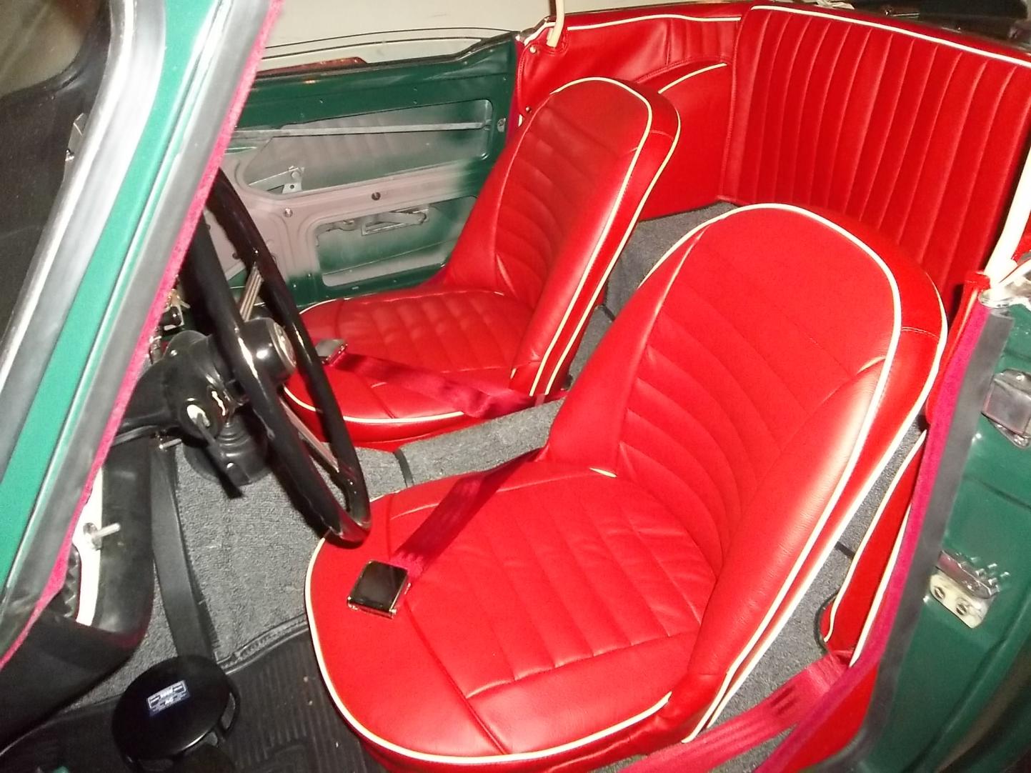

I am currently restoring my TR4 and two weeks ago I did the seats with a bright red leather kit from TRF.
For the most part the instructions that I got with the original style padding kit were fine.
I took one seat apart and restored it prior to starting the other and took a lot of detailed photos as I took each seat apart.
I also did some internet research and thought it was relatively easy compared to some of the comments I found. Unlike some of the comments, I did not find it was difficult to get the seat back down over the frame and padding.
Vila

If you are referring to what appears to be different colors of red on my TR4 interior, that is not the case.
There are 4 different red materials in the photo; leather seat surfaces, vinyl seat sides and interior panels, fuzzy door seals (whatever they are made of), and seat belts.
A visual look under both sun and incandescent lighting, all the red looks like the seat color, except the seats are not as shiny as the picture shows.
It must be the way the flash reflects off the different materials, especially from that fuzzy door seal material.
