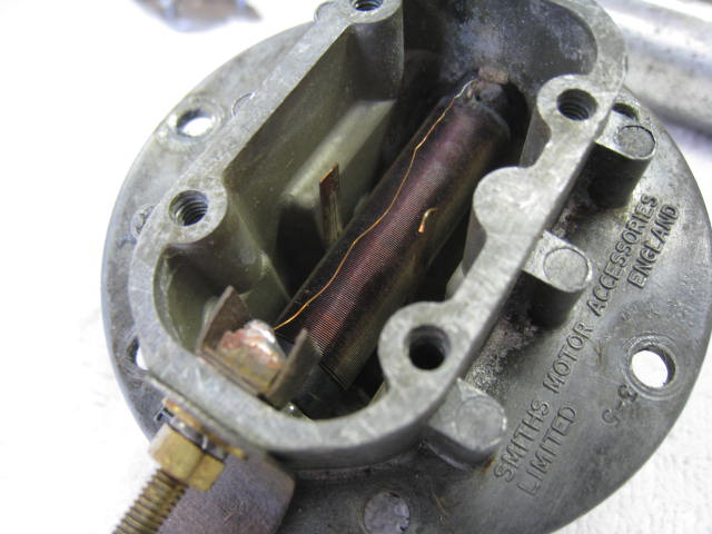

Hi Ken, remove the sending unit on top of the gas tank. Mine just needed to be cleaned up, as the wipers on the sides weren't making contact. Also check the small wire that protrudes away from the unit towards the edge, mine was broke. That small wires is grounded to the tank when the screws are tightened. I also added an additional ground strap from one of the mounting screws to the rear bulkhead.

Here's a photo of the inside of the unit, for reference.
My sending unit wire was broken. I soldered it back together. You can see the silver solder at the end. Works fine now.
Good luck,
Roger
