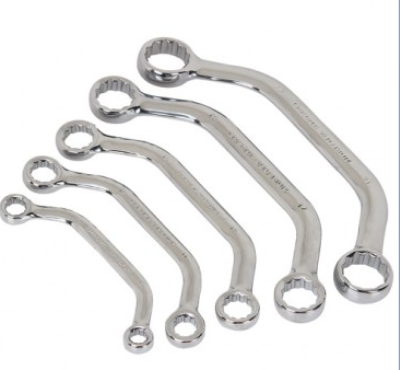

Try one of these obstruction wrenches (9/16" as I recall?). I use these and just work at it bit by bit.
S-shaped wrenches may give you some wiggle room also, but I haven't tried them.
