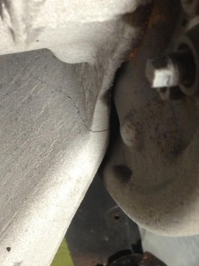

My TR6 has just returned a from media blast and I have discovered cracks on both trailing arms. The cracks are located on the bottom of the trailing arms near the hub (same location on both TAs). Is this common? Any advice on repairs?

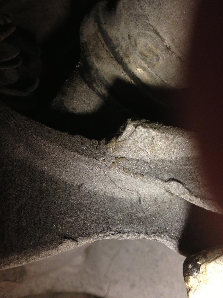

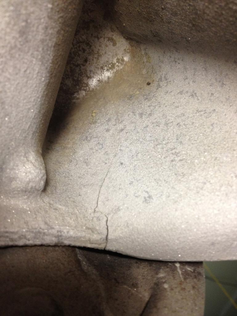

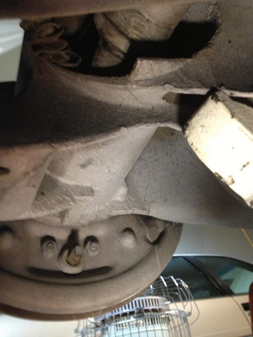

Ok, thanks to everyone for the posts. After getting a closer look, both TAs are cracked in similar locations. Although I have no way to know for sure, there is no indication that the car has taken a hard hit. Especially one that would have resulted in both TAs being cracked in the same location. Not sure about track use, but there are no obvious signs.
It doesn't appear that this is a widespread issue, but I can tell you that I would have never found these cracks had I not had the TA media blasted. I have uploaded photos so that others can inspect their TAs for similar issues. I have these TA to a TIG Welder to see if repairs can be made. If not, I'll be contacting Wayne about purchasing replacements.

Mike, What a surprise to see those. I see our normal breaking on some of the flange bits where the axle goes through, but never have seen what you have. They must have tried to do a Duke's of Hazard jump. Let me know and I will give mine and extra look before we come up with something to make you happy.

Your lift arm theory is arguably the best so far. Since the car was largely original when I purchased it, I don't believe that it was raced. Also, having disassembled the entire car, there are no indications that the it has been in a major collision. At least nothing that would have caused both TAs to crack in the same location.
As others have suggested, if this was a common problem, we'd likely have heard about catastrophic failures. But, since these cracks could go undetected until the TAs are thoroughly cleaned (hence sandblasted), who knows how many cars have similar problems, or at what point that a failure might occur. If you are doing a restoration, I'd definitely sandblast the TAs and inspect. If you are not restoring, I'd seriously consider getting the car off the ground and inspecting the best that you can.
