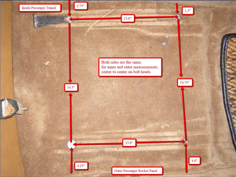

On the recent 888 thread, Todd mentioned Ricaro seats being an option for the TR7/8.
Since my seats are out being re-padded, I took a picture and the dimensions so it will save someone the effort if they are looking for a different seat to use. Both the driver and passenger side are identical, so use the inner for each and the outer for each.
Don asked if brackets were available and none are to my knowledge, but these would be much easier than a TR6 to retro fit newer seats to.

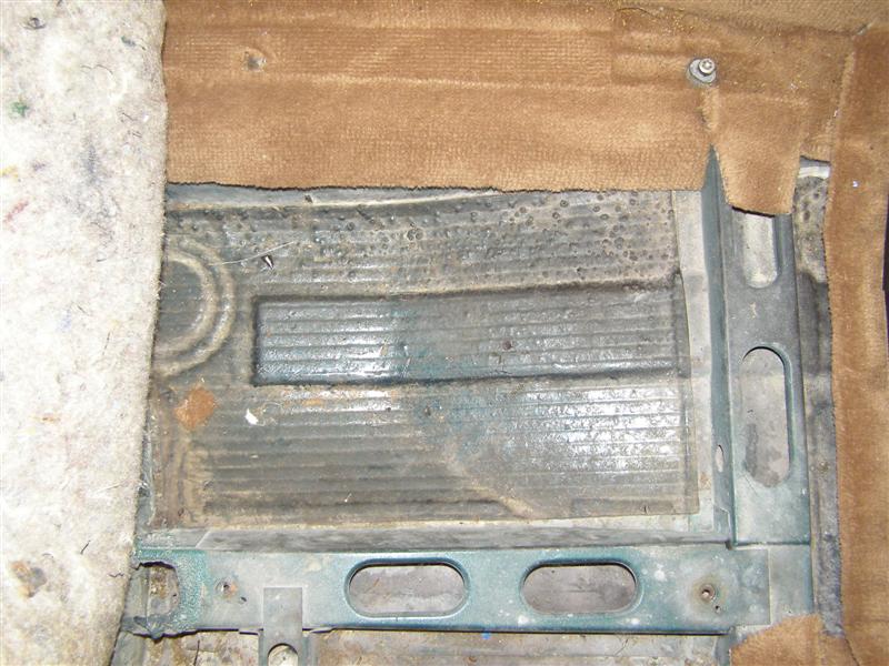

I also measured the sides from the bolt center to the tunnel and inner rocker panel. Plenty of room in these.
The first shows the measurement and the second shows what's under the carpet.

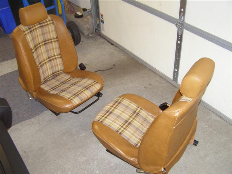

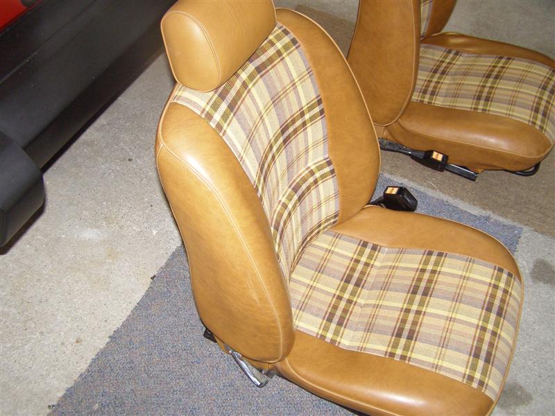

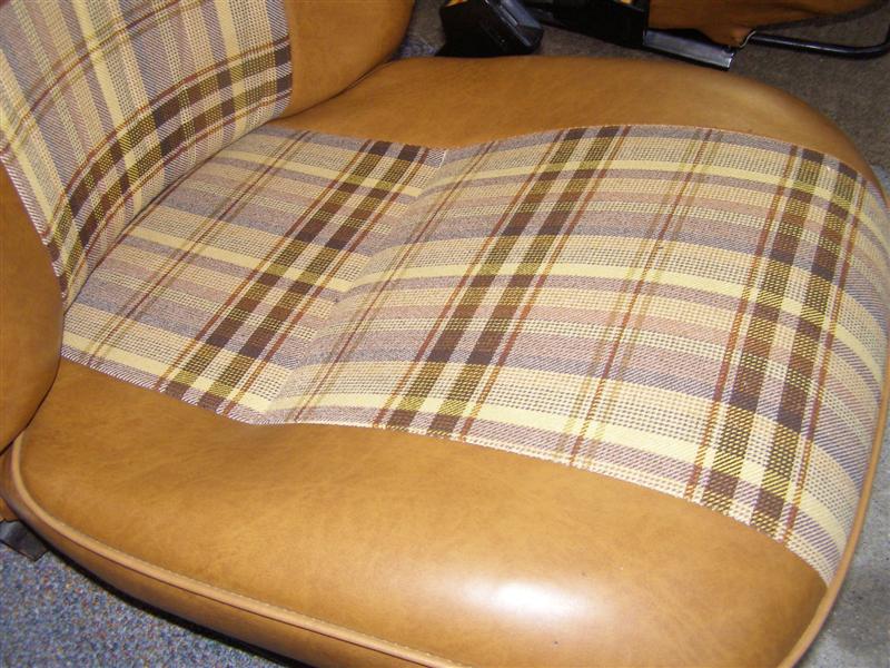

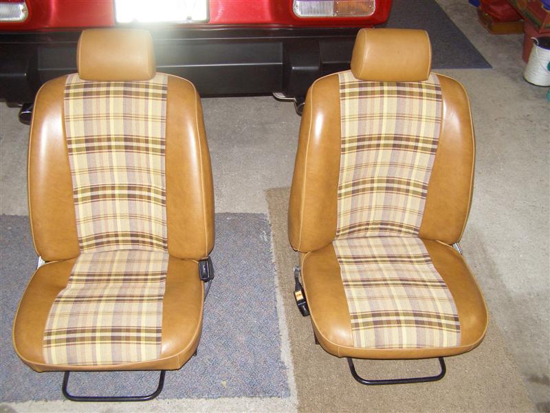

Almost forgot. The seats were finished today, but the visors will be next week. Mucho padding in there now.

Mickey Richaud
Wow! Looks like somebody slipped a few balloons in there! :laugh:
Brosky
Brosky
Mickey, this fat butt of mine needs a lot of padding!!

Paul, did you take out all the bolstering on the side ,or, twern't there any?
By the way, what are those spots in front of the seats? :jester:

Don,
The spots have been there for years. I don't know what this is. Too close to the door for oil, might be paint.
I'm not sure I know what you mean about the side bolstering? The seat trim was folding back on itself, due to the collapse of the padding on the backs and bottoms, so Eddie torn everything out and started over with a bare frame. Nothing unusual on a 30 year old car with foam in the seats.
See the wrinkles in the original seat back pics about mid back high? Also the bottom was coming loose and tearing at the seams, so he took the cover apart, bonded new material to the back of it, then sewed it back together before installing on the new trim.
