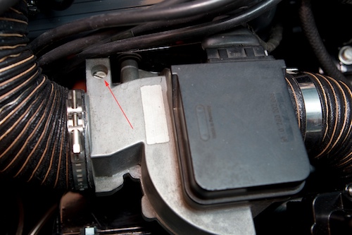

So what does the adjustment screw on the TR8 FI Airflow meter do??
This one:
Darrell_Walker
I know we are discussing this on the wedge list, but just incase anyone comes here to look for an answer. That screw allows you to fine-tune the idle mixture, by allowing a portion of the intake air to bypass the flapper. The opening is quite small, so it has little effect beyond idle.
