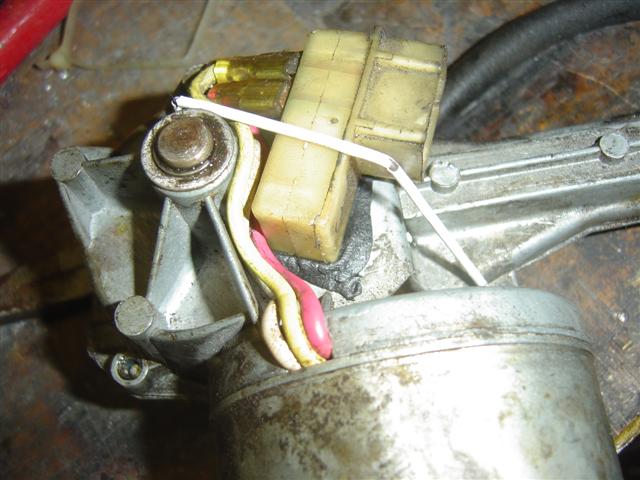

well got the cable out, took the wiper unit apart to regrease and PO has a nylon cable tie holding the plastic connector to the housing, the plastic connector has the automatic cut off switch, I figured there must be some type of clip that held it on the metal housing but I cant see what is broken off so I guess I will have to go back to a nylon tie. but so far so goood

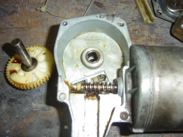

Hondo.....I'm not sure what clips you're looking for but here's a picture of my wiper motor opened up before I removed, greased and painted it. I've got a few more pictures if you think they will help.

underneat the housing where the wiring harness attaches to the unit is a plastic part that the harness plugs into that is what is loose but I got it covered would attach pics but I dont see an attachement button, but got the unit regreased and back in this pic is just of the gear housing after cleaning the grease out

I put that black stuff between the plastic electrical housing and the metal base to keep moisture out of the gear housing, its NAPA non hardening sealer and the wire is coat hanger wire bent as a clip to hold the plastic housing in place, I drilled 2 holes opposite each other in the cast web for the attachement holes thats the best I could do,
