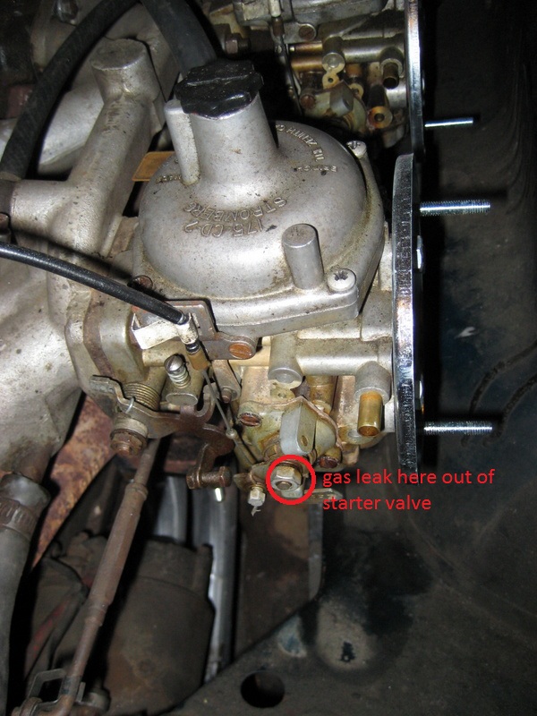

About all I could suggest aside from what I already have is go thru the dripping carb as see if you did anything different. Make sure the choke's hollow disc has enough spring pressure behind it to keep it pressed against the body of the carb and there are no grooves that might be diverting the fuel into the starter box housing
AND if you put Grose jets instead of the original needle valves, replace the original needle valves unless you have reason to believe they were malfunctioning..Even if you replaced the old needle valves sometimes even the brand new needle valves stick open, so think about putting the old ones back
One last thought for tonight..make sure the dripping carb is not dominating.
Check the balance between the 2 carbs again.
