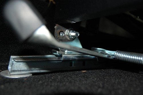

On TR6 seats, is it normal for the seat hardware to bump up against the "B" pillar? Here's a pic from my recently installed seats and tracks:
When I got my car, the seats were not permanently installed, and I wound up getting some older TR6 seats from a friendly BCFer. I installed the seats and tracks using a TRF kit. I'm 6 feet tall, and feel I could use an extra 2 inches of seat travel, but don't quite have it. I think my TR3 has a touch more legroom, in this regard. This is making me think about Uncle Jack's seat kit for Miata seats.

I had the same problem. There are two holes on the front seat attachment. It will help if you put the bolt in the back hole on the inboard track.

I too needed a couple more inches of seat travel (I'm 6'3") after I rebuilt my stock '73 seats and cleaned up the track assemblies. I noticed that when the seat tracks limited the travel there was still a lot of space between the back of the seat and the rear step and that the passenger seat went further back than the drivers seat. Following a tip I found online (I can't remember where, but I can look for it if you want it), I took a large screwdriver and tapped the forward roller in each side of the track back a little bit and this allowed the seat tracks to travel aft quite a bit more.

I seem to have enough seat track travel, it's just that the seat hardware fouls at the end, by the doors ...
trrdster2000
Kevin, you need to take the screw out of the lever and move it where you need too for clearance. It's a square fitting, so someone just put it back on wrong.
