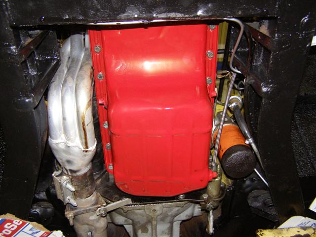

I found this old picture before my engine was done, but after I replaced the clutch hydraulics and switched to silicone. My new line from the master to the braided line looks a lot more like your new one than the old one.

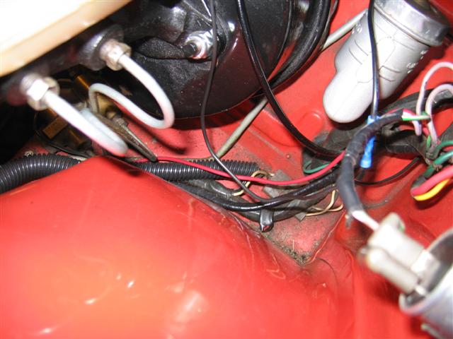

I hope that this may help. Pre-engine again, but with usual leaks.

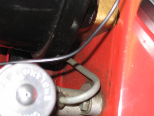

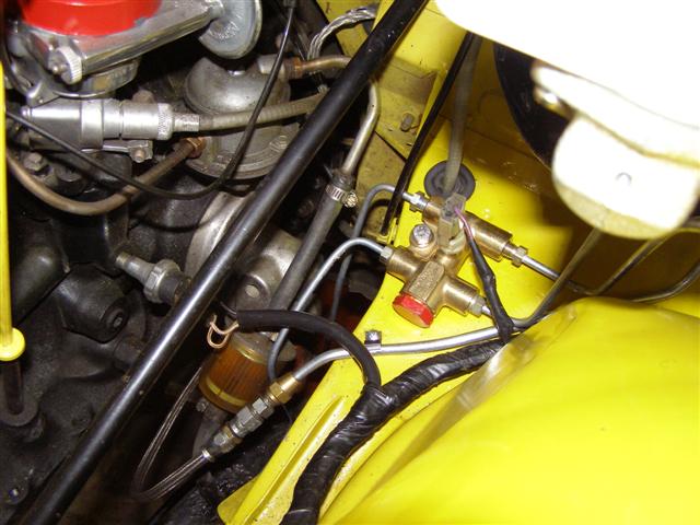

found a couple pics of my 6 that may help

That's a better view Casey and the one that was asked for. Some knucklehead just before you, posted a picture of the bottom of his car, rather than the top.

Thanks, fellas, for the <span style="font-style: italic">hand</span>, those will be a great help. I printed Paul's first picture to bring out to the car, now I'll do Casey's as well... Thanks again!

Thanks to Paul and Casey for the pix.... I printed them out and, with a little massaging with a brake line bender, buttoned it up. No drips, no leaks, no errors.
