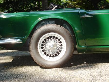

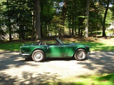

Let me try and figure out how to add a photo of my current wheels...
Happy New Year
Bob
RJS
Let see if this worked:
RJS
One more (now that I figured out how to add pictures!)

RJS's set up looks hot. Geo's painted not chrome wires are the look I love. I have experienced that tires make a HUGE driving difference on any car however budget put skinny Kumhos on the original wheels with probably over priced tubes and strips from big 3. Will never change from wires (I just can't) although given the cost of mounting, tubes, pita ect I would in retrospect just have waited for sale time and gotten new wires to start with. Oh, then splines and better skinny tires than the Kumhos. Oup's, budget. All that's really needed now are a couple of spokes. I am glad I didn't go crazy cleaning up the old wheels, some steel wool and caliper gray paint...fine for now.
