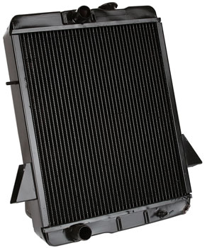

Has anyone done this? The later radiator is wider than the frame rails but it looks like it would fit in front of the rails.

I was under the impression that the Tr3,4and 4A used the same rad, only difference being the the long neck on the 3. I cant see why a 4A rad wouldn't work in a 4.

Early tr4's HAD the tr3 radiator with the long neck but lacked the hole sometimes for the crank.Later the neck got shorter and by the 64 the neck was gone. Just make sure that when you are doing this job that you uprate the fan.My favorite is the tr7 13 blade.Just cut the old paddles off and trim the hub to fit the 7 part, drill and use.

The TR4A radiator is different and wider as Jerry indicates with wider lower mounts and different upper mounts.
The TR4 had at least 2 radiators (although the SPC lists 3 part numbers). The early one had the extension like the TR3 (up to CT9552) while the later one did not.

If anyone has used the later radiator, I am trying to see how they fit it into the car. Why would you use the later one? because it has more surface area for cooling.

Jerry- My impression was it would not fit, I think the frame rails on a 4 are narrower than a 4A since the 4 basically started with a modified 3 frame so the inner rails are TR3 dimensioned. On the 4A I don't think that is the case, I expect you'd have about 3" more clearance.

Well, we may have a brand new radiator that you can get with free shipping then. I have a feeling it just is not going to be worth it to fit. We did want the extra cooling from the larger size but maybe that won't work. Some more measuring on Friday. Jerry

My friend decided he wanted the larger radiator. His car overheated with the TR3 type. So we trimmed the inner frame rails and then welded back in plates for strength. The view fromt he front looks the same as before, if you did not know it came with the other radiator, you could not tell. There is plenty of frame up there at the front end. This way the radiator fits and needs no longer hoses or adjustments to the fan. We are looking for a better fan than stock, any ideas?
