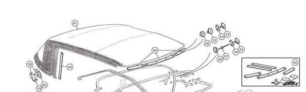

Finally installing the early TR4 top and bows and have a question about the three stiffeners that go in the pocket up front at the windshield lip. Are these supposed to be riveted in place? If so, what type of rivets are used and do you rivet from the bottom up so you only pierce the underside of the vinyl pocket or do you rivet thru the entire pocket exposing the head on both sides? Hope this makes sense... It's been years since I've seen an assembled TR4 top and I don't recall ever visibly seeing a rivet head. Any help would be appreciated.

I'll recheck my top, but I don't think you need rivets. I do know the stiffeners have several holes implying the use of rivets, but I've never seen a top with them to my knowledge.

I did not rivet those in but I did sew the ends closed. I did not want them slipping out.

I too use no rivets. Once the top is on they aren't going anywhere and they don't move easily enough that they will drop out as you fold it away.
