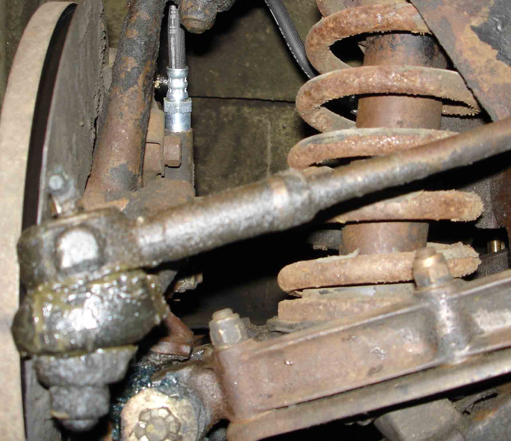

CT is below the cut off, I did notice the spacer per the drawing. Also noticed no bumper. I am leaning, no pun intended, that the springs are pretty week. I will investigate a stiffer spring and bumper before bending metal. THANKS!!! Pic attached
