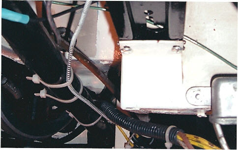

Only 3 of the metal "tie wraps" were used for the temp gauge line, all under the hood. The other 2 are to secure the vacuum advance line. There was a black wrapping kind of like "friction tape" underneath the metal strap.
Don't have a good photo handy, but maybe this will help.

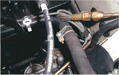

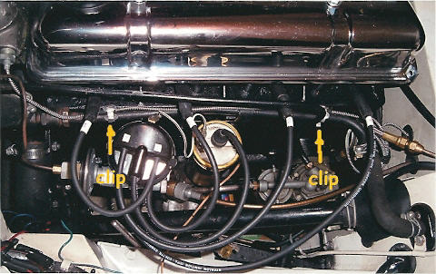

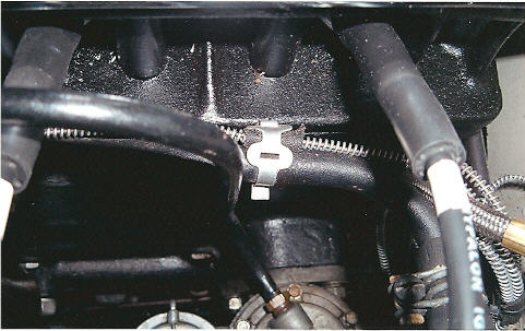

Tom,
Here are some photos that I hope will help. Notice that under each clip (and there are only two of them), there is some frabric (electrical?) tape wrapped around the tube.

Thanks Randall for info and pics ,I sorta got the kinks out but have not installed defrost hose yet so not sure if thier routing is going to interfere in that area by vent.BTW I saw TRF has "preformed" hoses if I need them.
Thanks Lex for close ups.I wasnt sure if both slots in strap were used or what went under them but you cleared that up.I routed different inside car,going behind for the battery box and around heater,but still dont see where the hold downs under the dash go,maybe on one of those little L brackets on the back of the lower dash supports,?

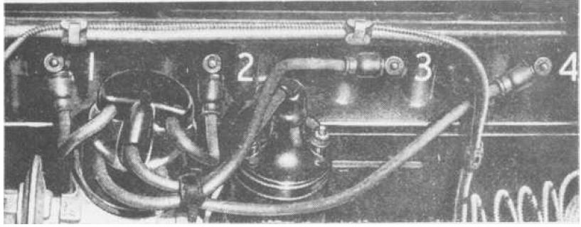

Here's the usual route which includes your 'around the heater' path. Sorry, I recall there are 2 clips but cannot say where they attach.
This is how I did it on my 3, but this is my work, not factory, so don't take it as the last word (though I tried to do what I thought was correct). Mine is clipped to the fuel line:
I used friction tape (hockey stick tape in some parts of the country) under the clips:

Thanks Geo,the last pic makes it clear.I saw that pic in manual and used as guide.There are two little L brackets on rear of lower dash suport,about 1" standoff with spring nuts that looks like they might be for the cap tub after it 90's behind the battery box,or what are these support bar mounts for?
