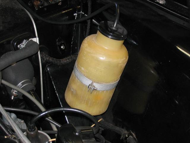

In looking at mine, the bottle is mounted to the inside of the driver'side fender, almost straight across from the #3 sparkplug if you are counting plugs from front to back. The tubing goes into the large grommet to the right of the steering shaft. (if you are standing in front of the car)

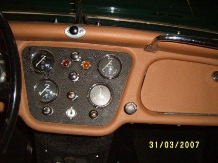

OK, I've got the washer bottle mounting position, but still need any info on where the manual pump is mounted - I assume it is on the dash, but can find no pictures or info anywhere. I'm at the point where I am ready to put the dash back in the car so any help greatly appreciated.

My TR3A SN is close to yours (TS448**) and I found a picture of the dash I took when I was back on the mainland. The washer pump is original to the car and is a manual push-pump type. I think "Tudor" made it but I'll check when I go back to SC for Christmas.

The washer pump on TS39781LO looks just like Jeff's photo too. Except my knob has a big chip out of it.

I bought my 1958 TR3A brand new with the added windscreen washer option. The dealer installed it. He put the plunger button over near the overdrive switch next to the rheostat for the heater fan speed. The model in mine is the Trafalgar. The bottle was craemy white (now yellowed a bit) polyethylene. The other model available was the Tudor brand which was similar but the bottle was clear glass.

Here is the button below the overdrive switch and the rheostat. I use black rubber tubing to make it "original". Clear vinyl did not exist back in 1958.
