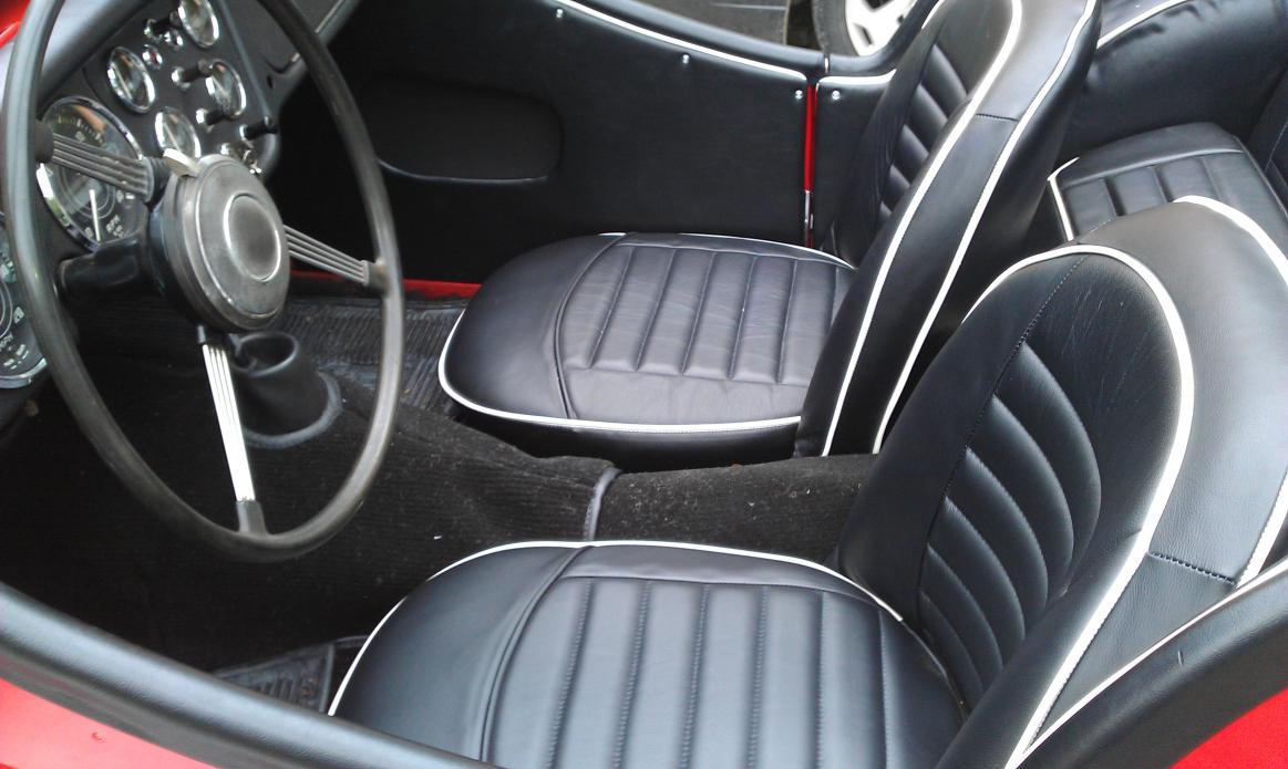

mgbmedic
This is my interior done by Tim Kruso. I have the seat foams and they are comfortable. If you send him your rail caps, he will cover them at no charge. Shipping is priced fair but I drove the 2 hrs to Dayton and picked mine up.

CJD
They look great! Those small wrinkles will smooth over time. Leather settles with use and temperature changes.
John
