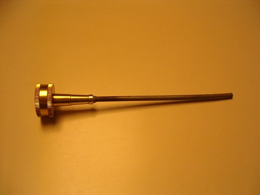

Periodically I remove the petcock and flush the block with a "water jet" I made using a piece of brake line and a small fixed hose nozzle. It lossen up and gets the crud moving around so it can be washed out of the block. Here is a photo of it.
