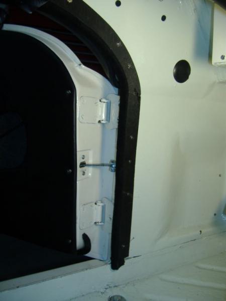

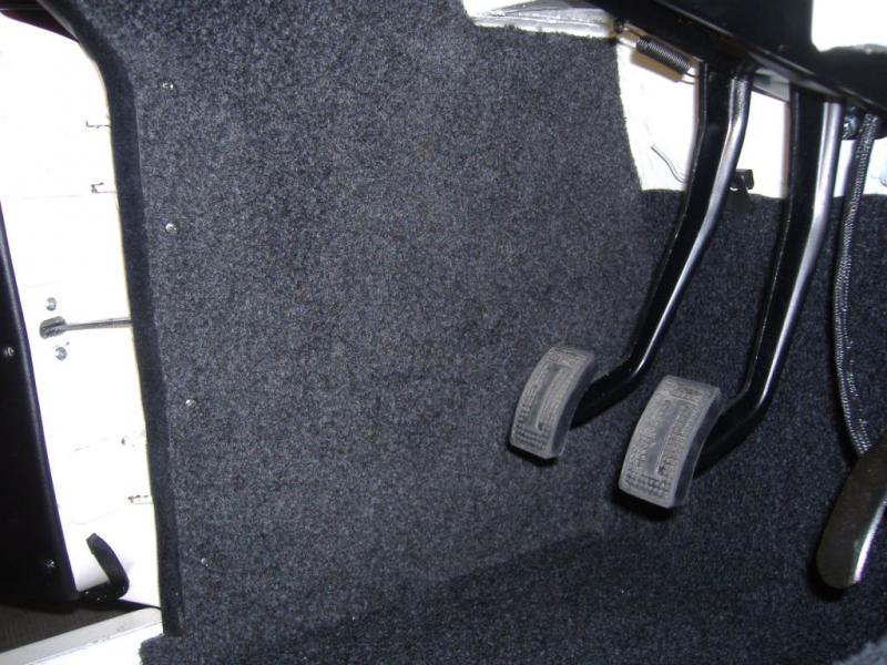

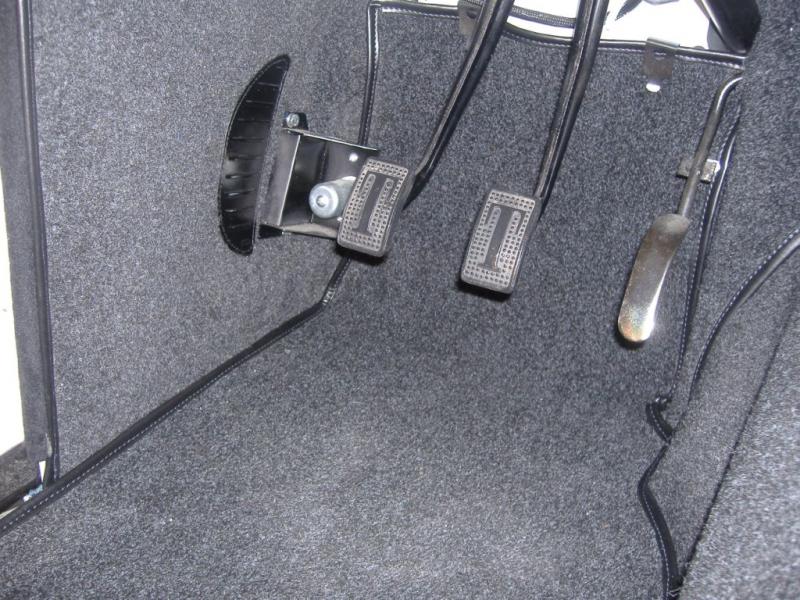

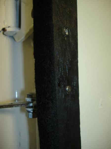

Tush,
I am attaching some photos of how I fitted my seals. Originally (at least in my 59 port 60K car) the seals were held in place by some kind of fibreboard strips shaped following the contour of the A post (shape of a jockey-stick). I fitted them with some small sheet screws, as seen in one of the photos. Later I placed the carpet with a little glue along the edge and with some chrome screws with chrome cups. But maybe this is not the correct procedure...
I am pretty sure that this topic has come up already in the forum (or maybe in the “other one”), and I seem to remember that the friends posted very useful an more detailed information.
