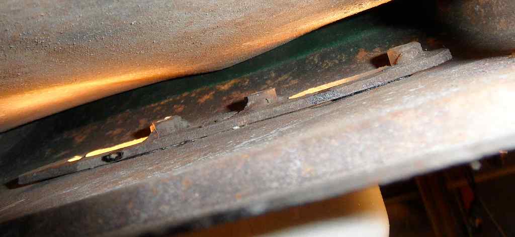

TexasKnucklehead
luke44 said:
I've got easy access at present.
Easy access isn't so easy. I just snapped this picture (of my '59 pre 60k). My front fender is removed (and the plate) and the camera barely fits under the edge of the cowl and the panel that is the inner fender/foot well. It is not visible from inside the car because it's covered by another panel. Anyway, you can see the nuts are welded to a plate between the panels.
MGTF1250Dave
MGTF1250Dave
Aloha,
Thanks for the photo and all responses. Assuming I can remove the screws, do you know if that plate is aattached to the body or will it fall free? I have a problem (undetermined what it is) with one of the dzus fastners so I think may need remove the guide plate for inspection.
TomMull
The plate is spot welded to the body. The location is not accessible without surgery. I used a large socket driver ground to fit the slot in the bolt that holds the stanchion, and an impact wrench. They came right out (perhaps just lucky). As indicated in previous replies, the plate cannot be easily replaced.
Tom
