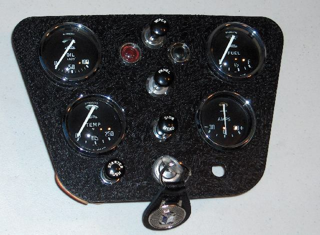

I got an early TR4 temp guage that uses a sending unit (off ebay). Aside from replacing the tube with a wire and the added vlotage regulator under the dash, I think it will be hard to tell the difference. -though it may be as hard to find.

Hi Tex - I have seen that approach before - the big difference being thew wire in stead of the cap tube under the hood . But sure looks the same to me from inside the car! I agree - likely just as hard to find...no luck with a core so far...

If you stil have the old gauge, you could remove the outer wire wrap and use it on the electrical wire to the sender. Makes under the hood look almost original.
