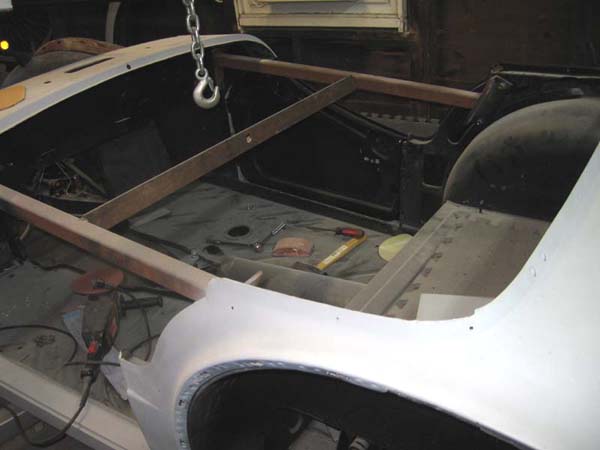

martx-5
jwolff said:
Hi Mike, I just checked out your photos. These gave me some great ideas as to where to attach my engine hoist to help support things...
I braced the door openings with some angle iron, and also welded a brace across the middle with a hole drilled so I could lift the tub on and off the frame with my engine hoist. Since I only have a one and a half car garage, I could take the tub off the frame, wheel it out in the driveway, and work on the frame and suspension stuff.
Edit: BTW, where the cross brace is located in the pic resulted in the tub being perfectly balanced front to rear.

jwolff
That's how I made my brace, plus I have another angle iron going to down to the prop shaft cover. Good to know that it is balanced from there. thanks
