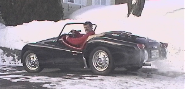

FWIW, I looked for a long time for gloves that would keep my hands warm, but fit comfortably and not impede driving my TR3A in cold weather. Finally bought some motorcycle gloves with garish logos on them, and ripped the stitches out of the logos, leaving soft leather backing and Gore-Tex facings.
I also found that a leather jacket works much better when driving in the TR than "ski" jackets and such. Fleece and nylon simply don't stop the wind that robs your body heat, leather does.
Although I've gotten spoiled and soft by the mild climate where I live, I have shown up for a New Year's day event in a TR3A with no top, no heater, and temps well below freezing on the mountain. Biggest complaint was my toes being cold /bcforum/images/%%GRAEMLIN_URL%%/smile.gif
