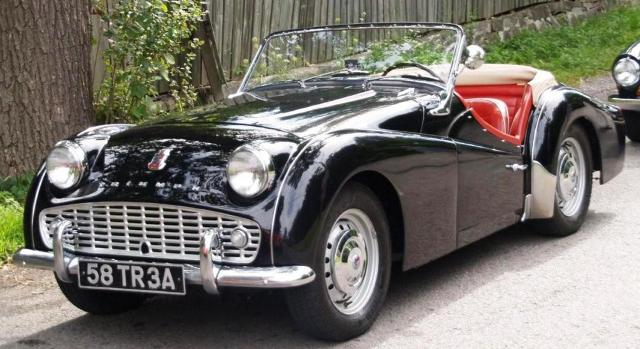

Sounds to me that the steel wheels are causing the vibration, but if it's shimmy, I'd say it's the silent blocs, idler arm and/or other ball joints etc. Maybe it's slop in the steering box adjusting pin. Tom has some nice alloy wheels on his TR3A that resolved his wheel problems. Was it shimmy or vibration Tom ?
My 1958 TR3A still has steel wheels. I run the best four wheels on the car - out of 10 wheels that I have collected and tested to find the best four. Of those four, the two better ones are on the front and it runs smooth.
I'm using 165-15 Vredesteins
