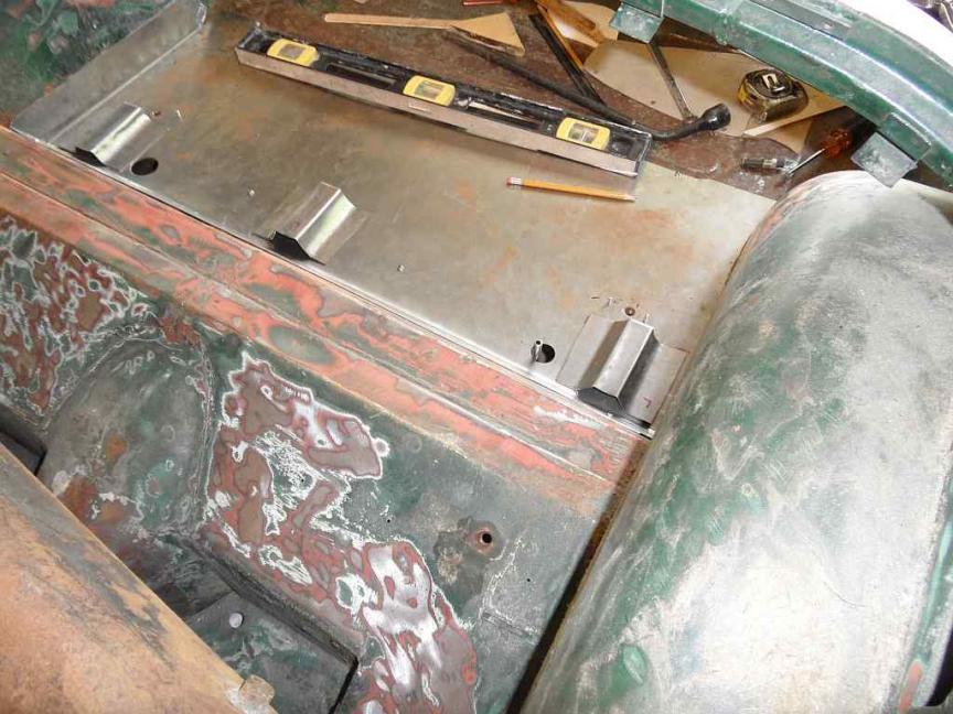

The shape of the tank, most importantly, the bottom of the tank is different between the old (sloped) and new (square) tanks. Since I had a *free* new style, I was able to modify the trunk to allow it to work in my old style car. Since I was welding a very large patch under the tank, I found the swap to be not very difficult -but I did have to make stands, and add a hole for the line.
