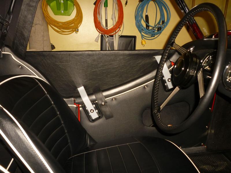

This setup is popular around here:
The upper wing is available from Moss et al; but I don't know of anyone offering the lower part commercially. It's easy to fabricate yourself, though. The aluminum strap fits into the front sidecurtain socket.
PS, a good leather jacket will block the wind better than almost anything else. Blocks rain too, if you get one with snug sleeves and keep it oiled.

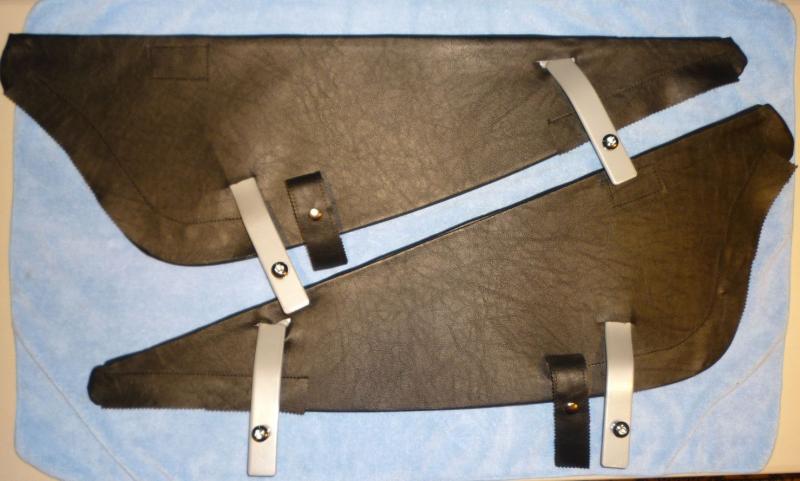

Resurrecting this post from last week as it inspired me to make a lower wing similar to the ones pictured above.
It really makes quite a difference at speed. Not something I'd want day-to-day but have a few long driving days planned and this should help keep me happy.
I fashioned mine with more upturn on the front edge so I could affix a stick-on convex mirror.
It secures in the side curtain bracket with an extra bonnet Dzus fastener.

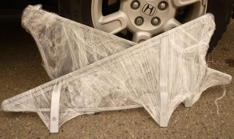

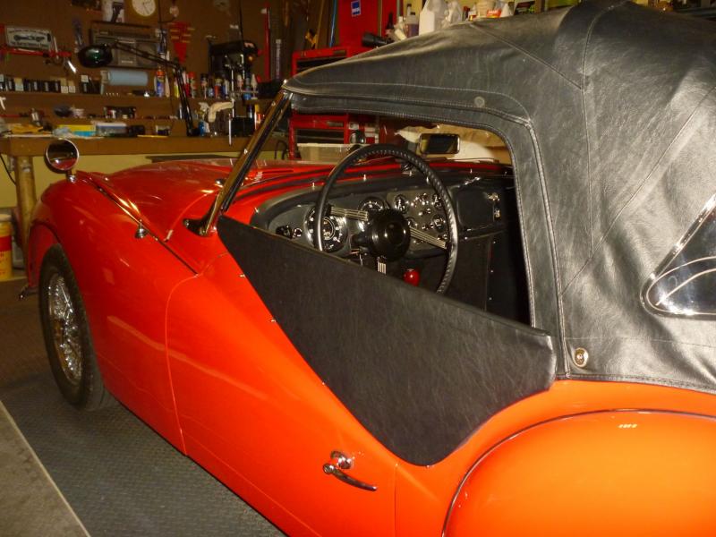

I thought that I would reopen this thread to pass on my efforts to prolong the top down season here in the great white north.
I was able to secure a ratty old set of 60's side curtains. I removed all the covering and cut off the top window portion. I then spent 3-4 hours with a wire brush cleaning up the metal, which was covered in tape, glue and rust. The dzus bracket fit was close enough. They went off to get powder coated in "Camero Silver". A trip to the auto upholsterer and the result is quite good. Fitting the new dzus connectors was a bit of a mystery, but finally came together using a socket and a gentle tap from a small hammer. Total expense approx $200. See the images below.
Steve
