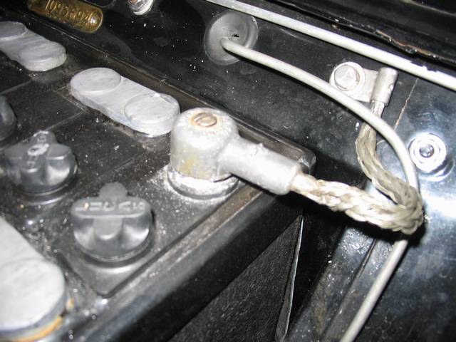

I never had any corrosion since 1990 when I made sure that the control box was adjusted to 13.5 volts (or whatever it says in the manual). If it is putting out more than the specified volts, it'll overcharge your battery, spit a lot of hot battery acis all out the caps and cause corrosion and leave residues. See attachment.
