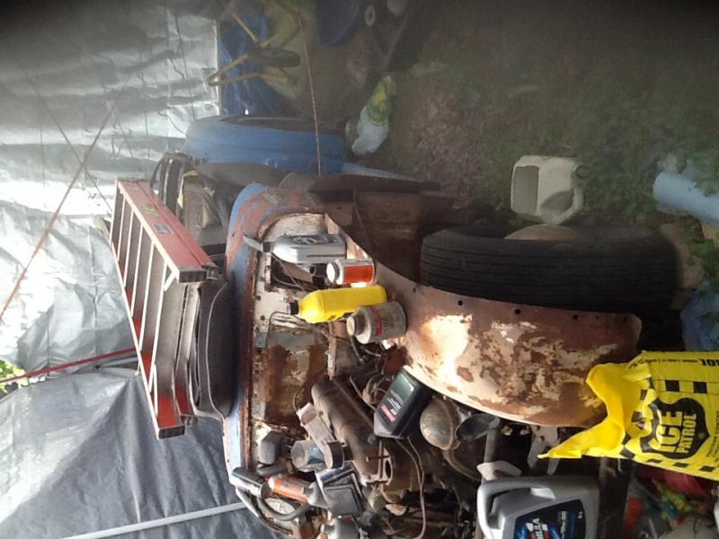

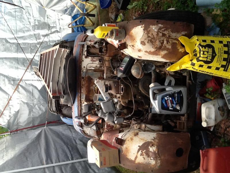

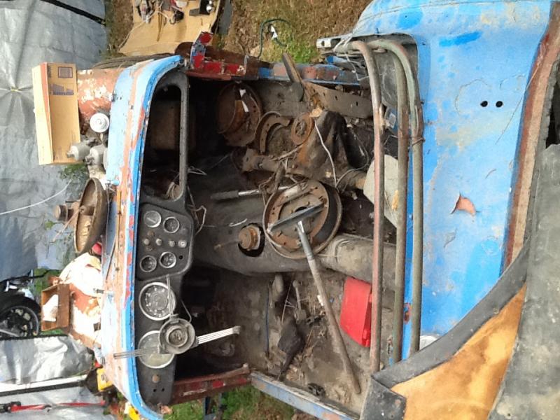

As promised here is a pic. Trying to post more the. One, but ipad won't let me for some reason.
Well it seems to have let me
Geo Hahn
...Geo Hahn -was the moss one complete? Did you have to buy other harness? Did it tell you what wires were what, we're they labeled? ( I'm colour blind to some colours so it can be a challenge sometimes lol) any other issues with it? Was it the correct length, or did you have to modify it some?
The harness I got from Moss did not include the sub-harness for the front lights, I made my own. Also, as I recall, I had to make the sub-harness for the instrument lights including the grounds that go to the speedo and tach. Neither was a big deal. Do not discard your old harness as there will likely be some correct color wire and old connectors in there that may prove useful down the road.
No labels or instructions on the Moss harness, but since the typical TR2 wiring diagram contained in the manuals is very literal (as opposed to schematics used on later TRs or current tracks used on German cars) it is pretty easy to see where everything goes (though color-blindness will make it a challenge). I laid the whole thing out on the floor in the shape it would have in the car and made my own diagram just to be sure I knew every wire and connector. If you do that you could add labels as you go for easier assembly later. I'm guessing you'll have time on your hands while the body work gets done.
The wires were the correct length except for the area around the control box & fuse block -- there they give you a couple of extra inches. I connected those w/o shortening anything then went back a year later and trimmed to exact length. Wanted to be sure all was okay - you can always make them shorter later.
Moss (and possibly others) offer a choice of wire insulation: lacquer braid or cloth bound. Lacquer braid is possibly correct for your car and perhaps mine too -- but I went with cloth bound as the colors on the PVC insulation are easier to read and the insulation possibly longer-lived than the lacquer which (in my experience) deteriorates over time and leaves you with hard-to-identify colors.
It is possible that several vendors get their harnesses from the same source so price shopping may make sense unless someone has had an issue with one supplier -- it's also a good idea to watch for the sales.
Thanks for the pictures -- a challenging but worthy project.
