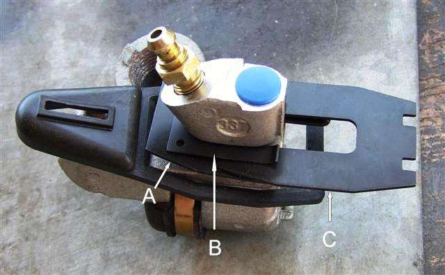

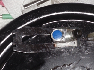

I am not having much luck at all. What am I doing wrong? I think I followed the instructions correcty, when I try to put the retaining plate between the distance piece and the spring plate, the entire assembly of the spacer and the spring plate slides towards the handbrake lever. The retaining plate does not "tap into position", if I continue to try to get the retaining plate to "seat" the distance piece will bend and distort from the pressure. I can put the assembly together without the backplate but once I mount the wheel cylinder onto the backplate it is very, very tight and binds. I did have success putting the distance piece and the retaining piece in together, with the open ends facing towards the hand brake lever, it's snug but is not correct according to what I understand.
Are there any tricks to taking the assembly appart without damaging the distance piece? OMG this is a pain! My problem is the first picture at the top the second one is the "example" without the backplate.
