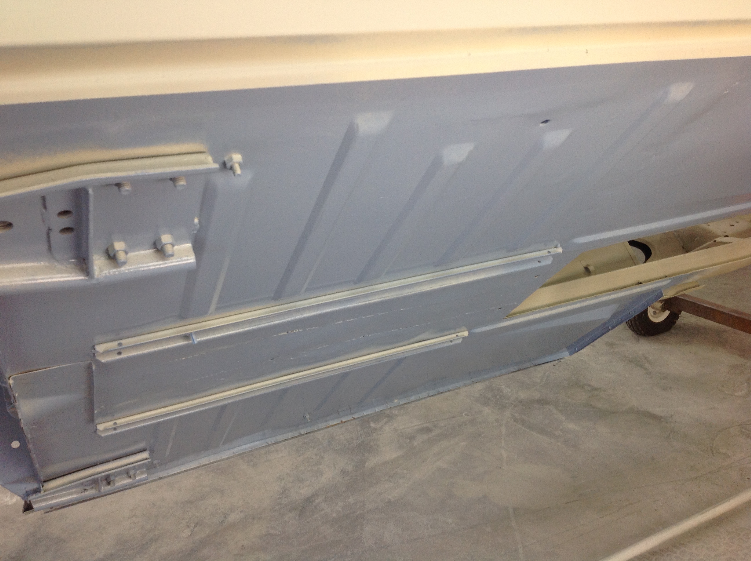

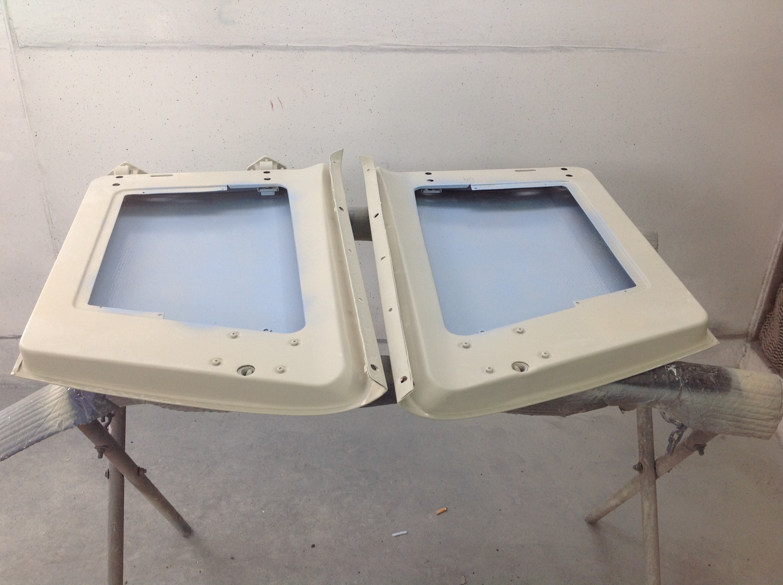

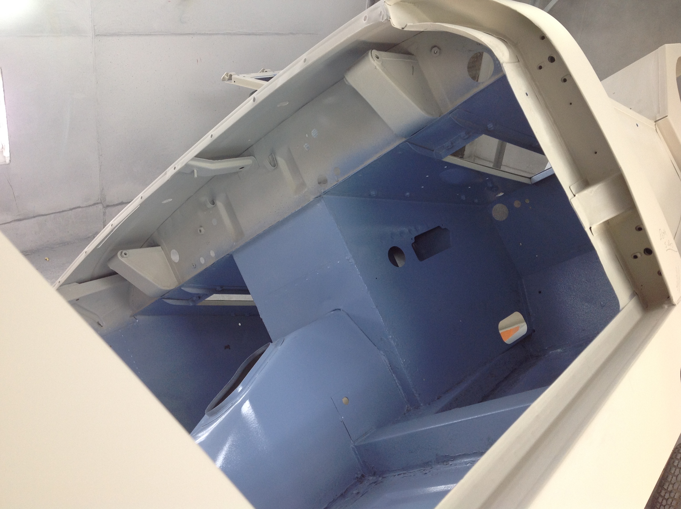

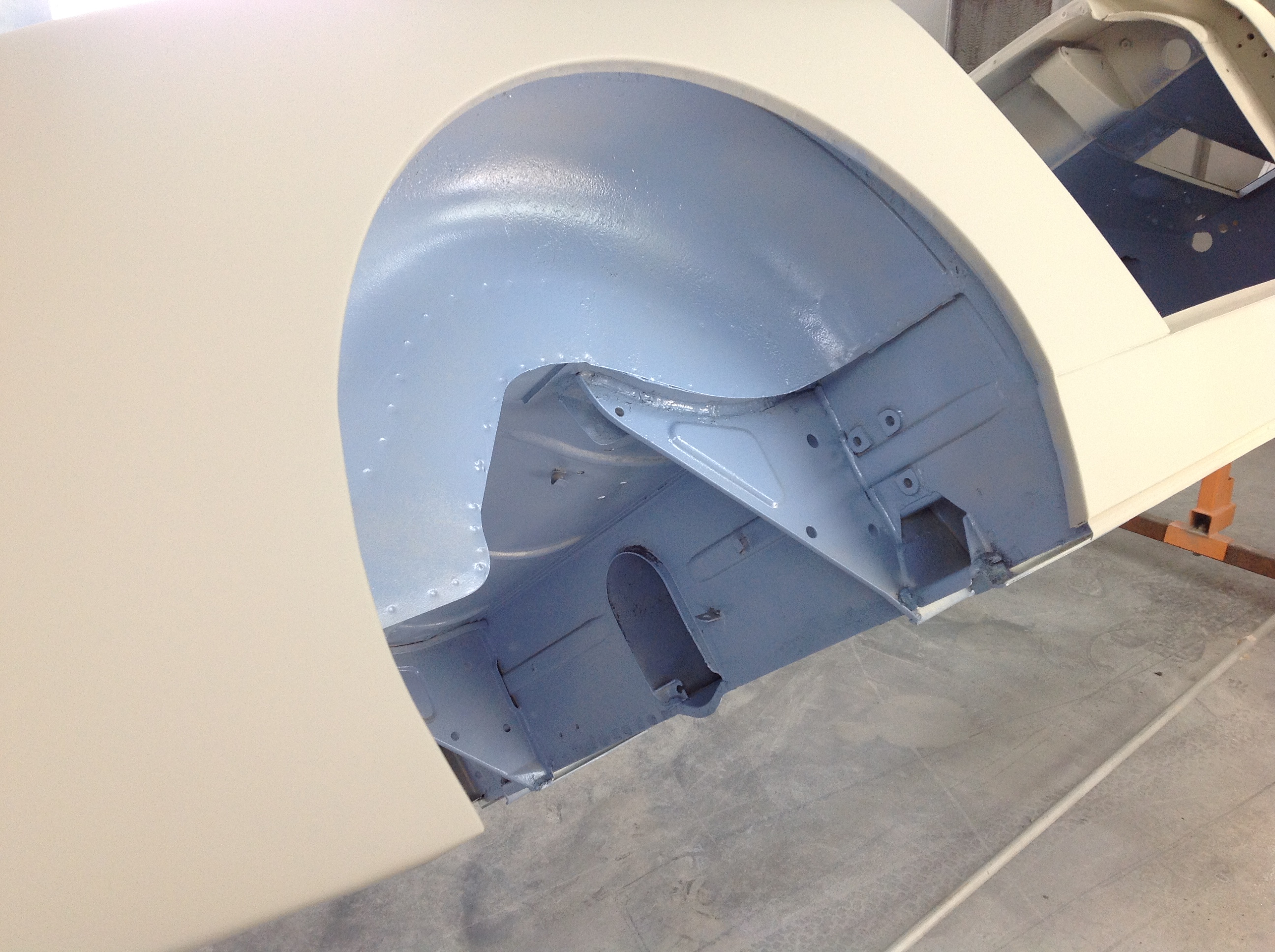

I’ve used Raptor Liner on several cars and sticks great, can be tinted and helps with noise, heat and vibration. The pictures are of a Bugeye in process of being sprayed with tinted bedliner over epoxy primer and I had the floor sprayed as well. I’m going to spray the underside of a 75 Scout II in the next week or so and I’ll probably put 3 coats on it since it’s an off road vehicle.
