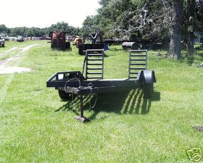

I have been thinking about getting a trailer for some time. It would be helpful for moving my still not running Healey around, and once it does, I will need it to trailer the car to far off events (Conclave '06) if I bring the family. I can't imagine the baby and the 3 year old in the the back during a two day road trip. Plus, I may be able to start hauling this to a couple of meetings so I can prove that I actually own a car!

This one went unsold on eBay, and it is about an hour away.
Here is the description I got for it
[ QUOTE ]
This is a 14' x 78" car or equipment hauler with 3.5' ramps and a 2" ball bulldog type hitch with 2 - 5000lb single axles. This trailer is in good condition with almost new paint and the floor is made of all metal with a wood center piece ,the tires are in fair condition and the trailer pulls great even with a heavy load so if you need a good car hauler this is the one for you.
[/ QUOTE ]
Any thoughts if this would be suitable for my Healey? What do you guys think it would be worth. It didn't sell at $799, so I am thinking that would be overpaying.

I have been changing my trailers around the last few months,
If you and your friends are going to be moving small British cars around make sure you get a trailer that the wheels will fit in the ramps, most ramps are too wide,
single axle trailers work fine for cars up to 2000 lbs or so, if you are pulling it with a full size truck or Van.
But my double axle trailer like the one pictured above will pull a 3000 lb car easily and without much tomgue weight,
I never had brakes on my trailers , but it might be a good idea if you tow car is not a full size pick-up or van.
$799 is cheap if its a factory built duel axle trailer

out here in cali, you could fetch at lest 2k for that trailer, if I were you I'd get it. if it had new tires and new paint it would definitely command a premium. the better part of a trailer that size you can mount a lock box near the front end to put tools and other goodies in, for when you take it to shows. I'd say if its within driving distance it wouldn't hurt to at least look at it, and if it has defects its definitely a good place to start.

My trailer, which my midget JUST fits in between the ramps (with some tire overhang on the ramps that slide into the beaver-tail) and with about 1" extra space from the insides of the tires to the inside of the flat space. It was previously used by a porsche/bmw racer, it is 16' long, with 7500 GVW, 2 axles and good tires, but needed brakes and a new receiver. We payed $1300, plus $2500 for new brakes all around, replaced receiver, remount taillights, add inserts to allow narrower cars to be loaded, and get two more ramps that fit in between the existing ones. $799 for a working trailer, with tires and brakes in any condition, that'll handle 5000 GVW is a steal. I was advised by a friend, who runs an RV business that 1300 was a good deal for the trailer we purchased. Since my mother uses it to transport the Scag (zero turn mower) from one place to another, we needed the inserts, etc. Now that the brakes are functioning, the trailer rides nicely and our 1991 1500 Chevy Pickup w/ 350 pulls it fairly easily.
