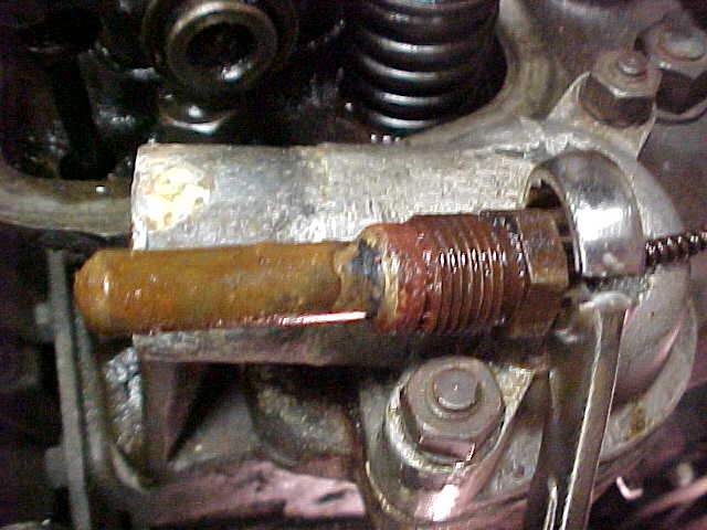

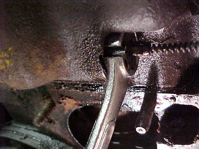

gents, heres my solution, first pb blaster soaking for two and a half days, tapping around the nut with a drift several times, then my new tool, anyone wishing to do this i recommend cutting it a the bottom end of its loop (see pict.) so it acts like a strap wrench when loosening and cant expand,-

AUSMHLY
Ya know Anthony7777, I bet we'll be seeing a version of this tool you made with the usual suspects.
Anyone notice that happened shortly after we talked and showed photos of turning the rear reflectors into stop/turn signal lights?
Anyway, back to the subject at hand. Great job! Nice photos.
Roger
stinky60
works real well, done the same thing myself,tried with a flared wrench but the head was to big.try to use an off brand wrench so you don't screw up your snapon tools
A
stinky60, thats a good point,i have a set of snap on wrenches designed to get around tubing, break lines etc, but the outside walls are to thick so i went to napa and bought a cheepy 5/8 for $2.50 /bcforum/images/%%GRAEMLIN_URL%%/savewave.gif
