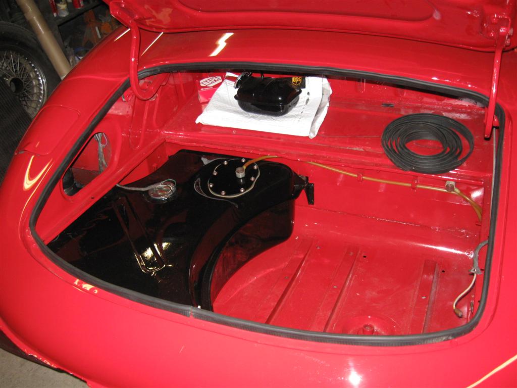

Yes, brushing is the way it is applied. I was concerned about brush marks showing up, but a friend sent me some pictures of the EType tank he did with POR15 and it is self-leveling and he had no brush marks. Looked pretty good in fact.

Looks good from here! I believe that there should be black plastic covers over the fuel line tabs that are bent over the line?

Yes, the tabs over the fuel line are supposed to have black plastic covers. It looks like in this picture the tan covers are there but were painted over. I replaced the covers on the tabs with new black sheaths on my car.
