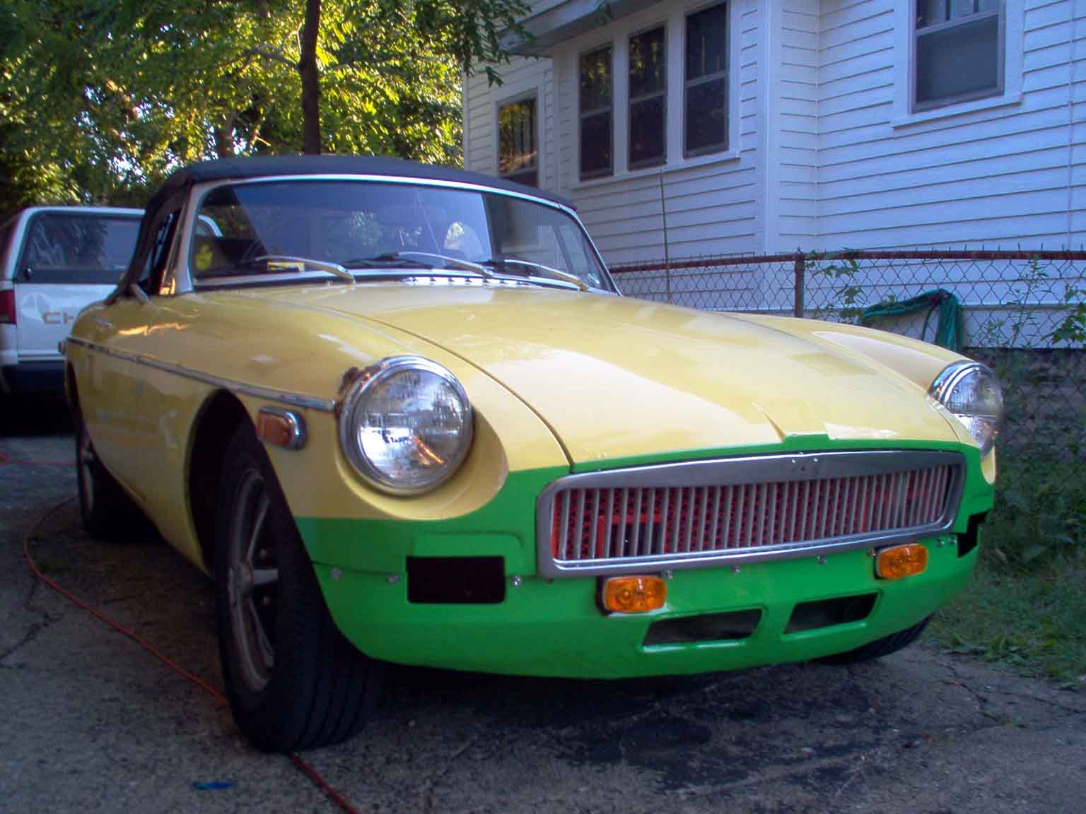

The Project: A "before" shot of the car.
Platinum
LOTS of rust holes. Used the "shortie" rear patch panels, this shows the cutout to accomodate the panel. I've used "Panel Bond" epoxy to attach the pieces. Great stuff... "Better Living, Through Chemistry!"
Remember: this is a ~driver~. Not to be put on a pillow and admired /ubbthreads/images/graemlins/wink.gif
jimd
Hi Dr. Could you explain the rear patch panels a little more? You made those cut outs yourself and plan to install the panels with epoxy? No welding? Where did you get the panels? How are you going to prep inside the well? Thanks. Jim.
Platinum
heh... Already done. Yup, I cut the holes with a thin cut-off wheel on a small grinder, used a die grinder on as much of the inner fenders as could be accessed, wire brushed and 36 grit sanded by hand what couldn't be done with that. Sprayed SEM "RustMort" liberally inside there and final treated with epoxy primer (Valspar VP 50) and colour. Ground the "contact area" of the repair panels (from VickieBrit- $35 each), gooped 'em up with PanelBond and used pop rivets in predrilled (~slightly~ countersunk) holes to "nail" 'em down. As far as I can tell, they're not gonna move at all short of takin' a hammer to 'em.
I ~did~ do some 'xperimenting with the stuff ahead of time on scrap bits: Steel and aluminum both... took bending the joint past 30 degrees (in a vise, with a BF hammer) before the epoxy showed ANY stress failure. Remember also: UH-1's (helicopters) were assembled in much the same manner. I've logged many hours in those and never saw a failure in the seams... Bullet holes, yes. I'll take the chance my B will stay together /ubbthreads/images/graemlins/wink.gif

Neat. I've heard the epoxy bond is generally stronger than welding. I'd love to see some in progress pics.
Platinum
Eeep! I did a bunch of "before" and "After" pix... not too many "during"s Me mits were generally NASTY "during" and so eschewed the camera handling. SWMBO has an actual J-O-B, so wasn't in attendance either. I may have some, but likely a disappointing few. Shoulda/woulda/coulda, huh?
You're inna trade, Banjo, so you'd pro'lly get a kick outta seein' "How-To's". Sorry. Take my word fer it: That stuff is GREAT if applied right. Used it onna floor pans too, and ya could safely have a square dance on 'em if there wuz enuff room...
