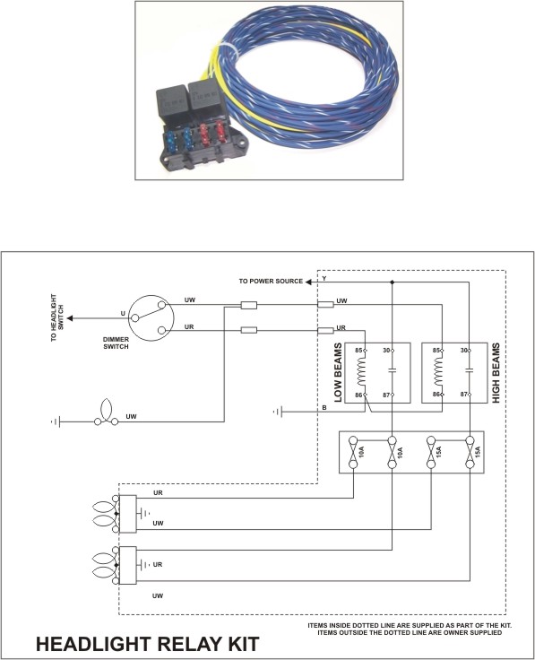

Do you have any good tips on exactly how to wire such a relay in to the circuit properly?

Yes i have the same question;as a novice how & where does one hookup a headlight relay. thanks Ken 1500 79 Spit /ubbthreads/images/graemlins/rolleyes.gif
danmas
For info on using relays, please check our website at https://www.advanceautowire.com
We sell headlight relay kits, but we have also posted the wiring diagrams for them on the web site which you can use freely to make your own if you prefer.

I suggest that you look at your car's wiring diagram along with the links posted above regarding relay panels.
Succinctly however, LBCs typically use a common wire to the dimmer switch. From the dimmer, the blue/red wire goes to the low beams and the blue/white wire goes to the high beams. Disconnect the headlights up front where their bullet connectors connect to the wires from the dimmer. My preference is to put a relay on each of these circuits (2 relays). Each relay has a ground connection to one side of its coil. The other side of its coil is connected to the bullet connector on the blue/red or blue/white wire (as appropriate) coming from the dimmer switch. Thus, your dimmer switch is powering the relays on and off. Each relay has one of its contacts connected by a fuse to the brown (always hot) post of the solenoid. The OTHER remaining relay contact goes off to the blue/red or blue/white wires of the headlights. I use Bosch style ISO relays as they are readily available from local parts stores and online. As mentioned, you can buy these harnesses or make your own. Bullet connectors and related components are available from most British parts vendors and from www.britishwiring.com

Well now that is one way to do it DK. However, because the dimmer switch is always in one position or the other initially aren't you still passing the lights load current through the dash switch when the lights are energized.??---Keoke
dklawson
Keoke, with the relays added the power passing through the dimmer switch is only powering the relay coils, milliamps instead of amps. The contacts for the relays (which then feed the head lamps) are connected by fused wires to the starter solenoid so the main lamp power comes directly through that connection, not through the dash or dimmer switches. My description matches that provided by Dan's link above with the exception of where I placed my fuses.
Piman, please notice that in my first post I suggested running additional, clean grounds. Relays were suggested in addition to the improved ground.
EDIT: Keoke, I was thinking about this more after my last post and it occured to me that it's worth mentioning that... once relays are installed they carry the lion's share of the current. However, the dash switch will still be carrying the current for the running lights. This will be much less than head lamp current... but it is obviously more than the relay coil current alone.
