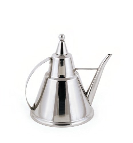

Gentlemen -- Where is your sense of style?
I use an olive oil dispenser, similar to this:
No kidding, I really do.
