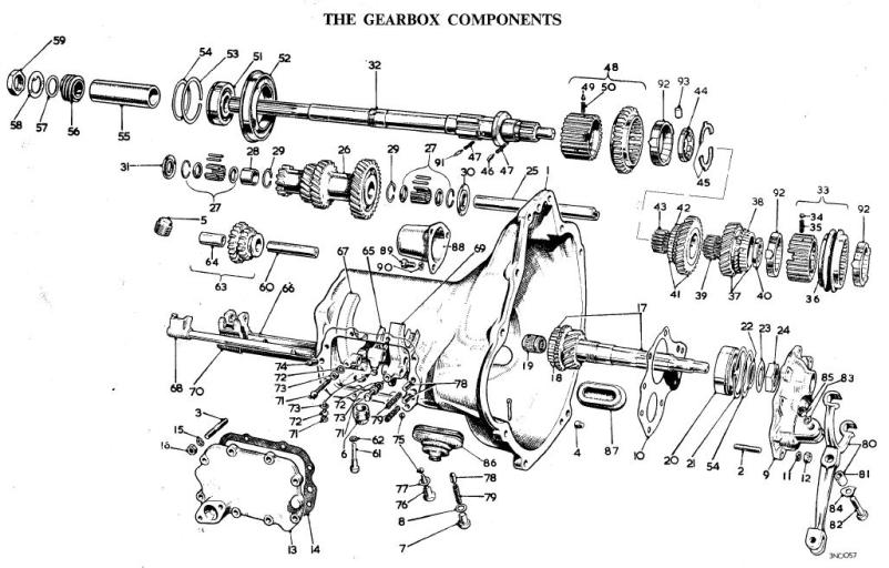

The issue with the tranny getting stuck in first is that the actual gear itself can travel too far to the point where part #93 begins comes out just enough to lock it in first. You have to push the plunger in while shifting out of first and into neutral. I don't know what the where part is that causes this but I put a metal shim (washer) on the shift rod to limit the travel when shifting into first. This is not the proper fix but since I don't know why it happens I don't know what the proper fix is.

I believe you'll find its the three little #49s that become slightly exposed when first gear slider moves too far toward the rear of the box. The three balls try to pop out and get far enough to keep the slider from being pushed back into place easily. A washer placed on the 1st gear shift shaft (at the very back) limits the rearward travel and cures the problem. For now, you may find that if you start the engine with the clutch in, then start down the street in first(of course), pull sharply back towards second with pulsing HARD tugs on the shifter (Pull-Pull-Pull!!). It may pop back into second. My A35 does it once or twice a year and the tug trick saves me from actually having to open the box and add the washer. On another ribcase, it wouldn't work and I had to add the washer.

On your stuck one, through the side cover you can see the bulge of the spring loaded balls trying to get past the over-traveled 1st gear slider. With three or four hands and several screwdrivers you can exert forward force on the slider while trying to depress two of the three balls at the same time. Just as much fun as it sounds. While you poke it and swear, you can see the position of 1st shift fork and it becomes clear where the washer needs to go to prevent it ever happening again.
