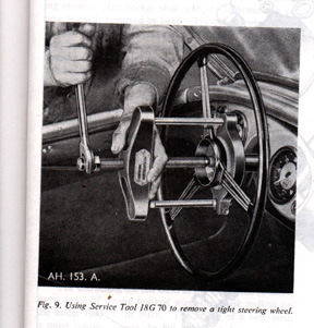

On the other hand, the non-adjustable type steering wheel is sometimes very hard to get off. There are two problems. First, the top threaded end of the hollow shaft has a thin wall & is easily damaged. The part where the top nut fits is larger in inside diameter than the portion lower down. A stepped peg which fits inside the larger diameter & contacts the smaller thicker walled lower diameter will provide a surface for the puller to work against.
The second problem is that there is no good way to get a grip on the wheel with a puller. Something like a split clamshell is required to bear against the back side of the wheel hub. The puller will pull against the previously mentioned peg on top & the clamshell on the bottom. I have attached a pic of the factory puller for reference.
If you are lucky, the wheel will come off easily.
D
