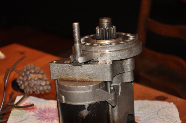

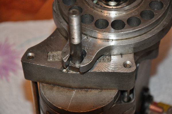

Here's some pics showing what Hap was talking about with the
Winner's Circle starters. Note the head of the bolt is "captive"
between two parts with an area machine to fit the head so
it can't turn and hence the whole install is MUCH easier.
Just stick that lower stud in the bottom whole and everything lines up fine. I don't know if this is a Winner's Circle starter
or somebody stole their trick.

Gundy said:
Done deal! Picked the starter up this afternoon. Bubba
went over it real good and tested all components.
$48 and change includes new..had to order it Friday and
had it here today...clutch. 20 minute install with the
new found access hole. Works great.
David, that looks like your PO clever add on, that looks like a High torque starter form Moss, maybe a Gustfason. The WC starters adapter paltew is not adjustable ( and really does not need to be) and the bolt bolt that is a fixed is a wheel stud installed in the adapter plate.
