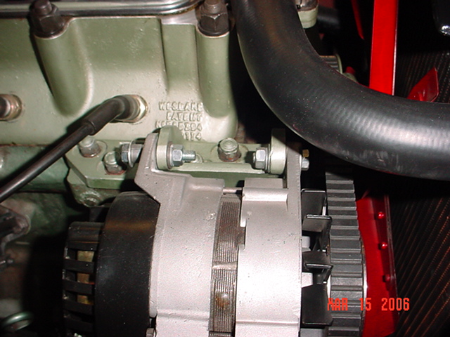

Ah!, but do they all suffer from the metal fatigue problem that seems to afflict the adjusting bracket?

[ QUOTE ]
[/ QUOTE ]
I suspect that the bracket fatigue problem has more to do with vibration of the very stiff & poorly designed original generator belt. I'm using the original bracket & adjuster with a more modern & much more flexible cogged belt. No signs of metal fatigue on the 50 year old bracket. See attached pic.

Hello Dave Russell, have to agree about your comment regarding the very stiff original belt, however the original design of belt was probably fine for the use it was intended to have as it was designed before WW2. I think they used wide heavy belts back then because the belt manufacturers didn't have the expertise to build a belt to a narrow spec and have it remain reliable. I'll bet having a lighter Alternator to spin will help matters also.
Hello zblu, have to admit to a bit of brain(?) fade here. I just realised i only read half your original comment. I originally replied as if talking about the mounting bracket which is why i said the 4cyl and 6cyl were different designs. Regards, BUNDYRUM.
