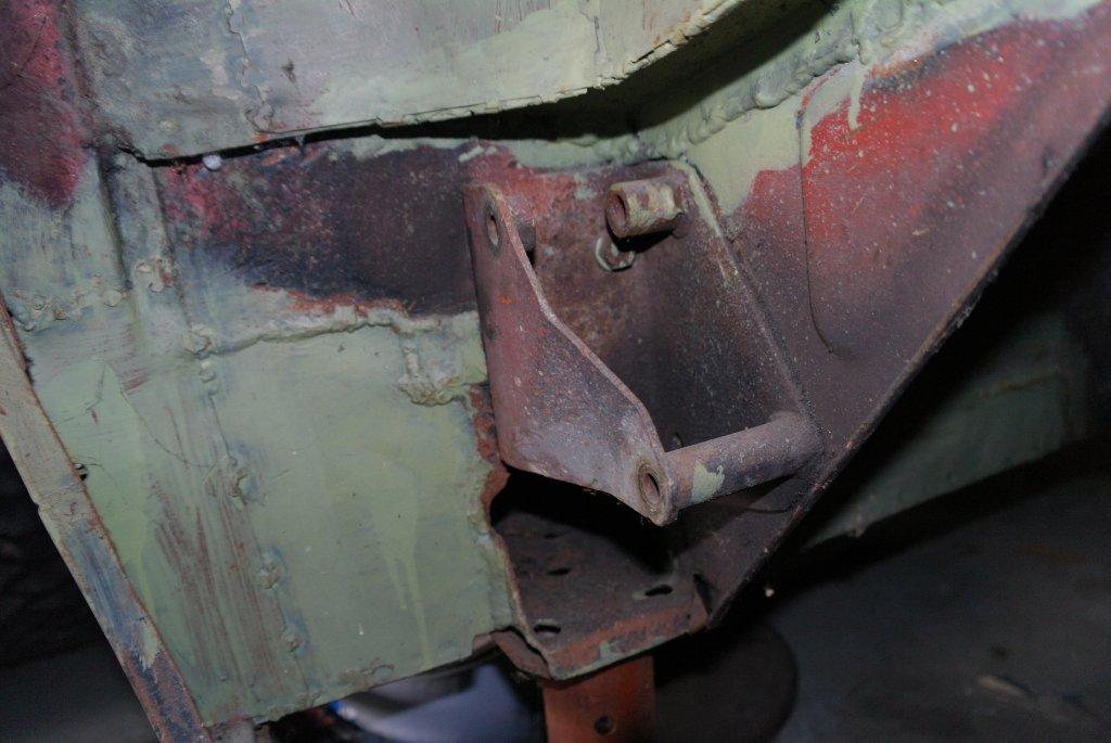

It will be on a rotisserie but I don't know with two HF Stands if I can go all of the way upside down. Not sure I want to add my additional body weight while on a rotisserie. I need to make sure Spring Mounts are all properly welded. The pieces around the spring mount are all 100% cleaned up but the side pieces that go between the side of the spring mount and side of the body were only tack welded in placed. I'm sure since all of the suspension is attached to that partial bulkhead panel that was installed on both sides it needs to be welded all of the way around. I need to take some pics and post. LR Suspension repair 2.jpg Not sure if this shows clearly but some of these welds on both sides were not finished all of the way around.

Look along the left side of the repair panel. Have same thing on the right side as well. Not finished where it comes close to the body. I plan on adding some additional welds and then POR-15 the underside and especially the spring boxes while on it's side.

Thanks Trevor. Any thoughts on those welds in the picture?
Any unfinished weld needs to be finished. I'd spend some time grinding down some of those welds, then place a wood block along the seam and give it a firm hammer blow or two to see if there was adequate weld penetration. I'd also apply seam sealer to all the welds.
