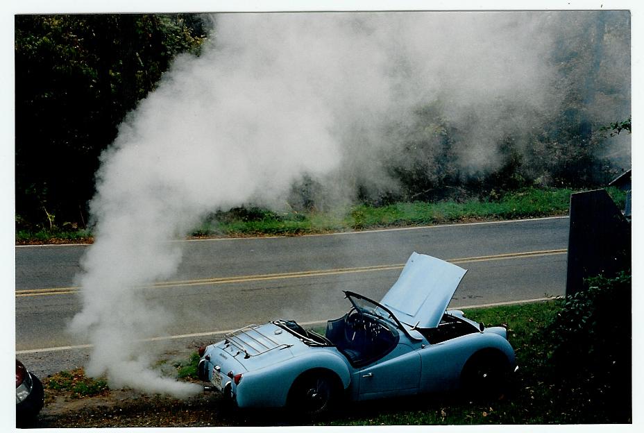

Gang, my TR3 is emitting large amounts of smoke out the exhaust (see attached photo). Is this normal or cause for alarm? The smoke has a wonderful aroma of roasting walnuts.
How can I cure this problem? The Patch?

John, white smoke like that is usually indicative of a coolant problem, a serious problem but much less so than blue or black smoke. Back in my younger days it usually meant a blown head gasket. A compression check should tell you whats up. Also look for coolant on the dipstick.
Good luck, Tinkerman

I'm assuming this is after the engine is all toasty warmed up? Running nice and smooth - just a tad foggy out the back?
Roasted walnuts - sounds like coolant to me. What's the coolant look like? What's the oil look like? If the oil looks "milky" - yep, that's the coolant going where it's not supposed to go.

Looks like head gasket leak letting water into the combustion chamber. Not good. Try retorquing the head and look for coolant in the oil. Change the oil if it is fouled with coolant.

My sympathies, John. The good news is that now you can practice doing the cylinder head R&R dance.
If the gasket isn't clearly toast, check the cylinder head & cylinder walls/liners. But that would be a big crack, so easily visible.

Oh sure. I actually studied the photo awhile to try to see how you photoshopped it -- but finally was convinced this is for real. Don't think I have ever seen one produce that much white stuff at idle.
My guess on what you'll find: A nasty moosh in the thin strip of head gasket between the coolant jacket and either cylinder #2 or #3.

Water in the tank maybe? Or perhaps in the oil... Did it start immediately, or only after the car warmed up?
But with that amount of smoke, I'd say head gasket.

All of ya are wrong! It was due to the walnuts in the exhaust catching fire.
Deposited there by mice or some other rodents.
Sorry, couldn't resist.

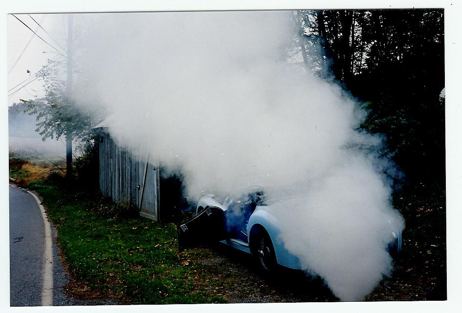

You're too kind, DNK. Here's another photo. Note how the smoke has filled the far meadow.
