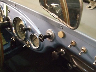

Thanks Greg, your all heart. :smile: It's one of these. Since they are not labeled maybe I picked the wrong one. Dave.
OH Yeah I see how you could ah made a mistake . :devilgrin:
vette
vette
If they were all in the down position then I was running on vapors for 2 hours. Gotta get those labels made. :rolleye:

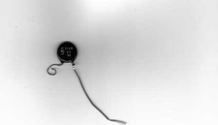

Hi Ray, I am interested in that TVS diode. Unfortunately I can't open that paper you wrote. I remember you talking about it sometime ago here on the Forum. I have alot of questions about it. Like what is it? Does TVS stand for "Transient Voltage Surpressing". I have a reasonable electrical background from the Community College and 40 years in the Electrical Distribution field but I don't know much about electronic devices. This TVS is still a diode. But isn't there alot of different technologies that TVS includes? So how do I know what to buy? And here's the BIG question, where do you buy it? The only thing people at radio shack know how to do is play with their cell phone.
I don't have the picture I took of the end of the fuel pump with cap removed in the computer yet. But I will post it soon. There was ,until I broke the lead on it, a device in series with the ground side of the points. It is round disc shape, black, about the size of a dime. At first I thought it was a capcitor. I took it to the only TV repair shop that I knew of, one that used to fix TVs and recorders but now the new owner really just sells stuff. He looked at it and said he didn't think it was a capacitor. It doesn't have a capacitor symbol on it nor does it have farads marked on it. He soldered an extended lead on the lead that I broke. I didn't do that because I thought the heat might ruin it. So anyway, what am I looking for in a TVS and where can I buy one. Dave.

Here is a closer look at the black device that was attached to the fuel pump. I don't recognize the symbol on it. Any clues as to whether it is a diode, capacitor or other? Thanks, Dave.

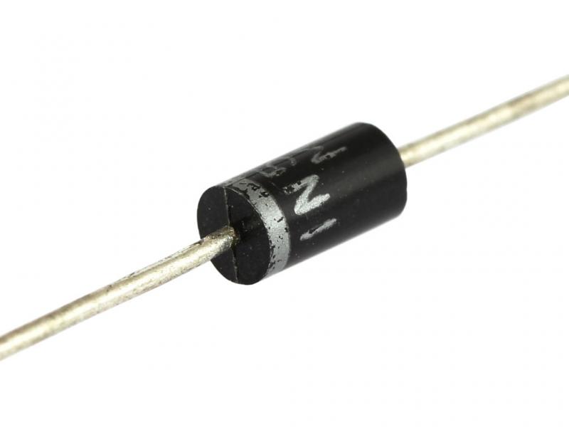

BigGreen
Diode's look like these
Yours looks like a capacitor
